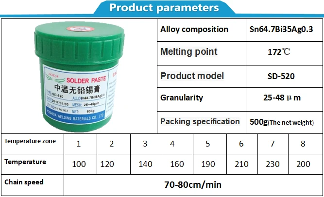

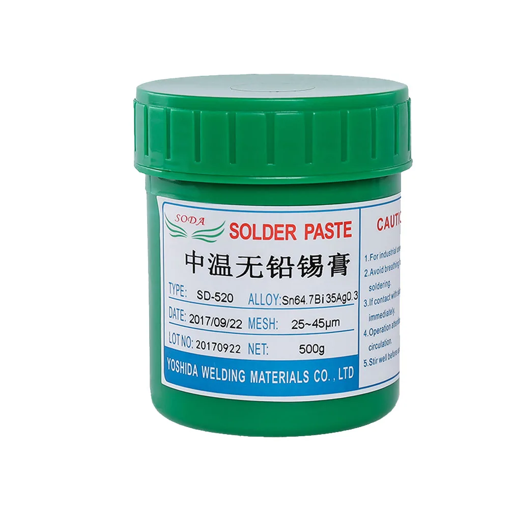

However, I've found maybe a pair different paste mixes worth mentioning:
https://www.aliexpress.com/item/32957672746.html
https://www.aliexpress.com/item/32955164321.html
Is this stuff being used in mass production? I wonder how does it behaves versus Sn63Pb37.
Found its melting point more specifically being listed as 178 - 183 °C @ HC Solder Products, seems like a lower cost version of Sn64Bi35Ag1 (probably eutectic, 178 °C).
¯\_(ツ)_/¯
