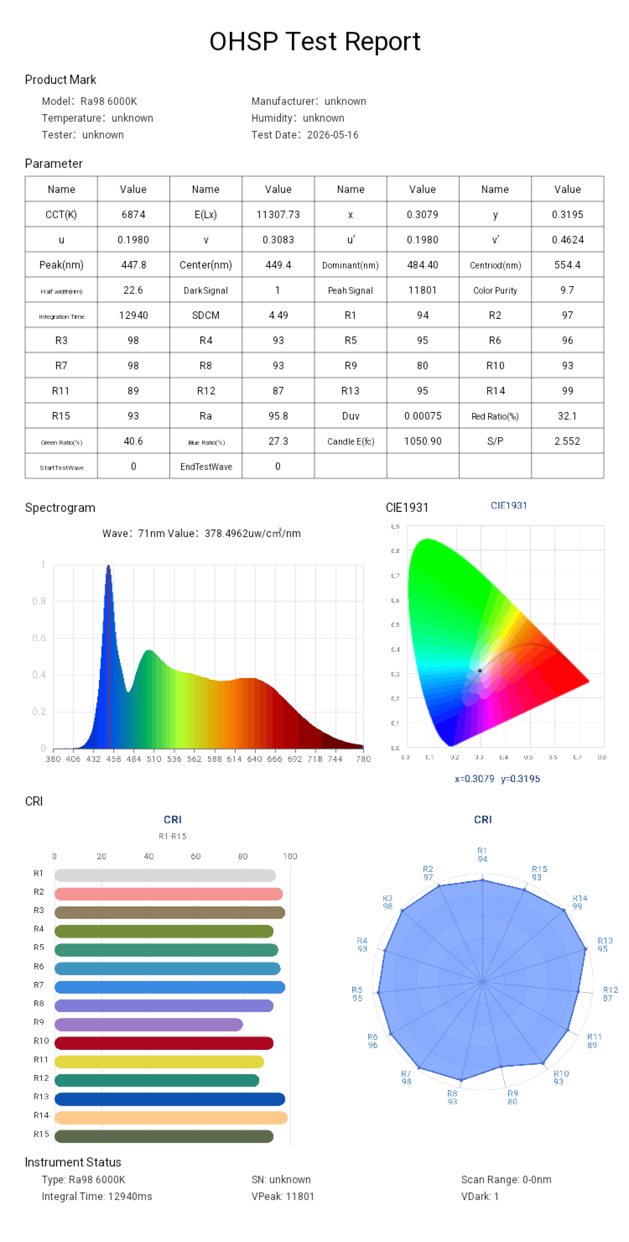

Spectra of these Ra98 LED Strips
When you were searching for LED strips on AE, you will probably come across these super cheap Ra98 strips in various CCTs: https://de.aliexpress.com/item/1005008107661113.html

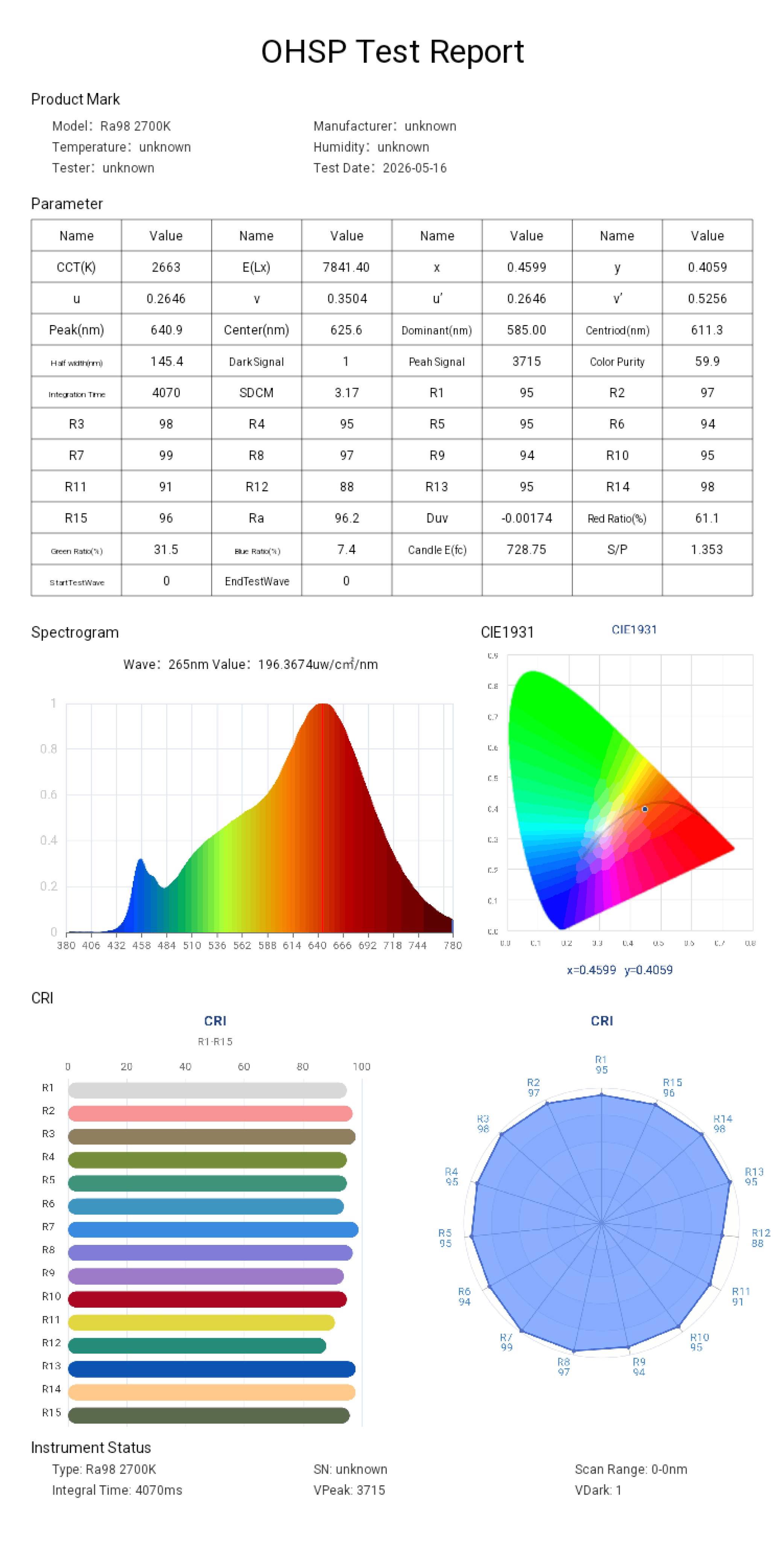

I have all the CCTs here and since I got the Hopoocolor HPCS-310 today, I wanted to investigate if they are as good as they look visually or not.
2700K

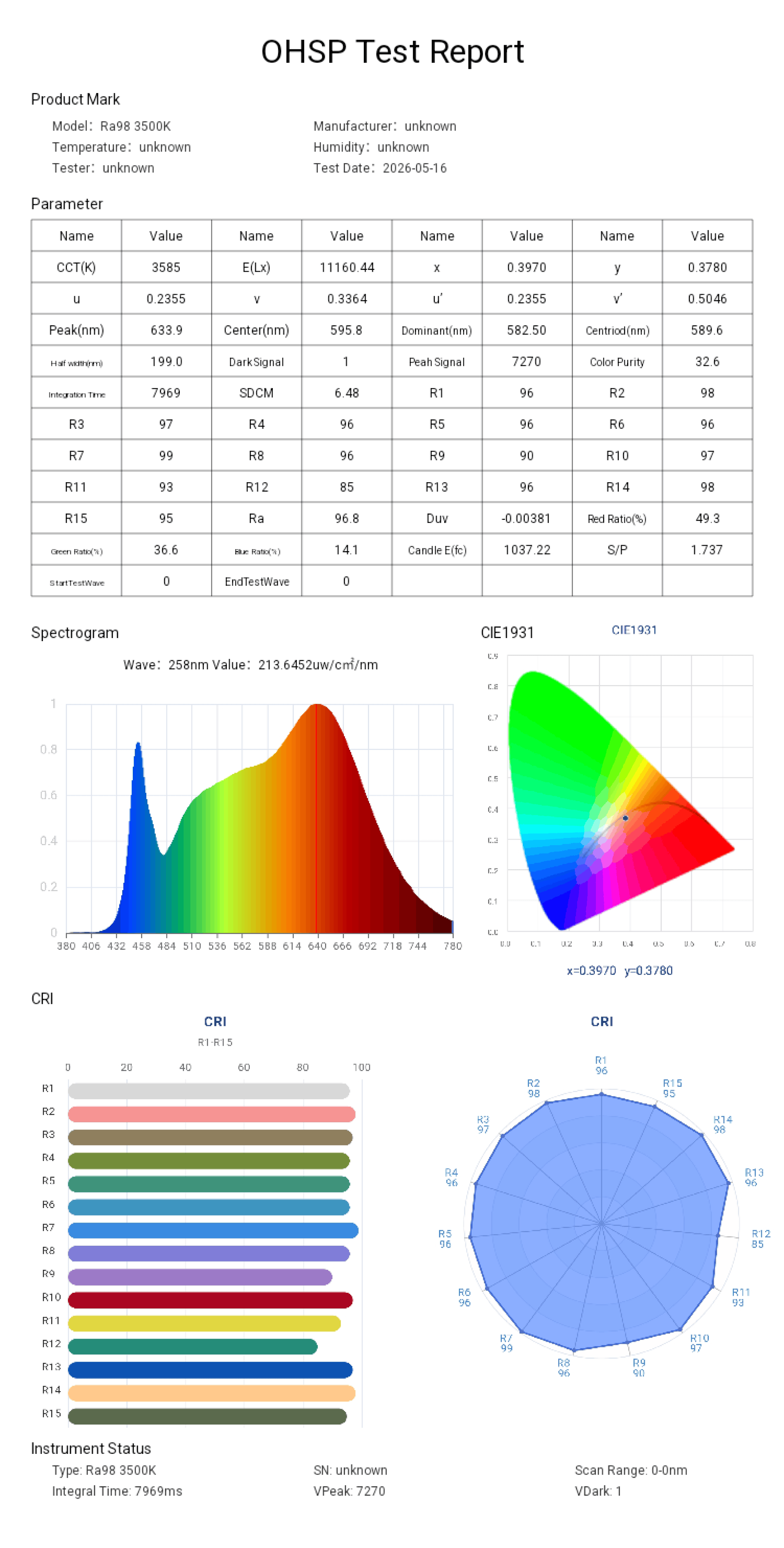

3500K

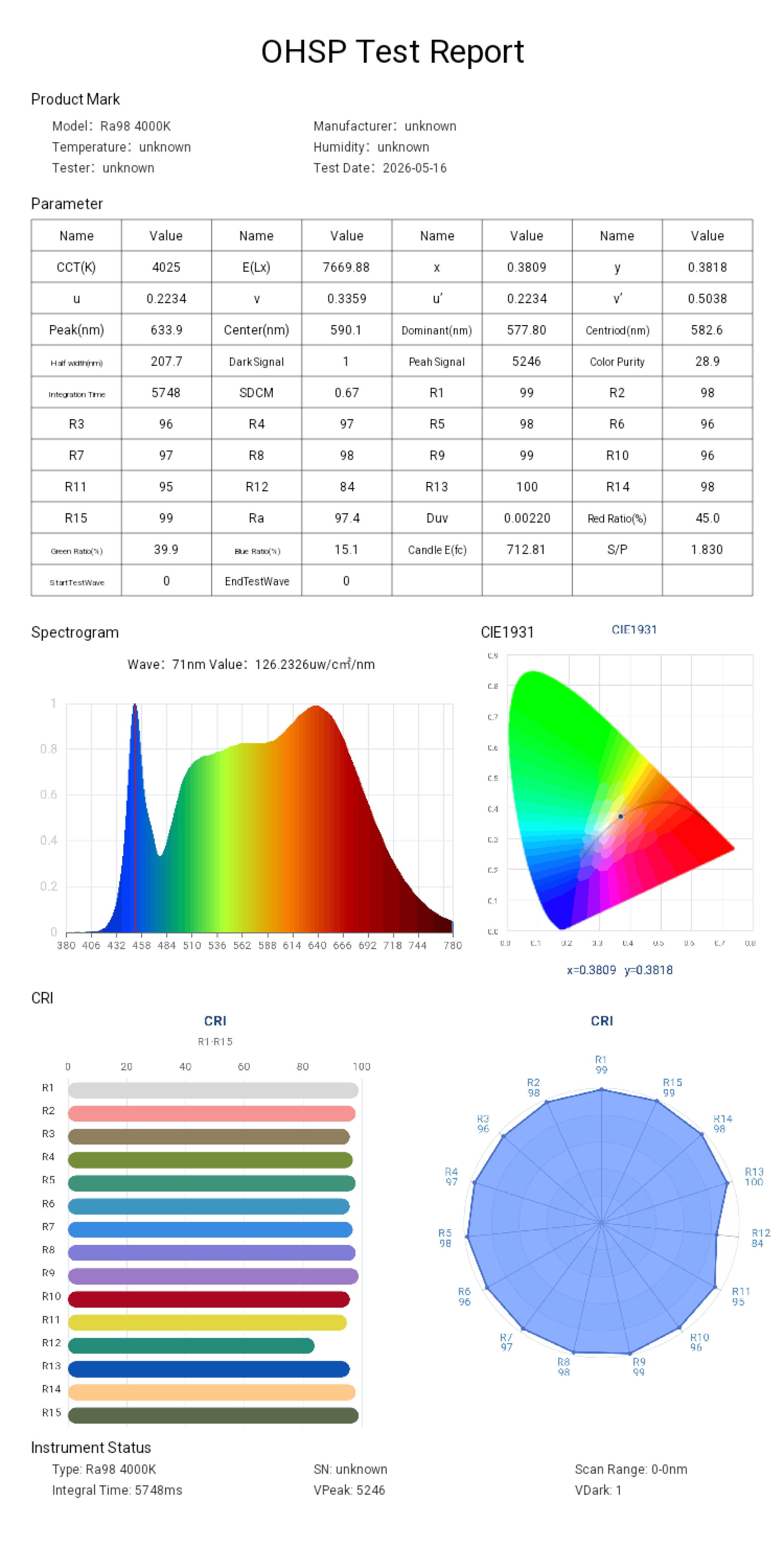

4000K

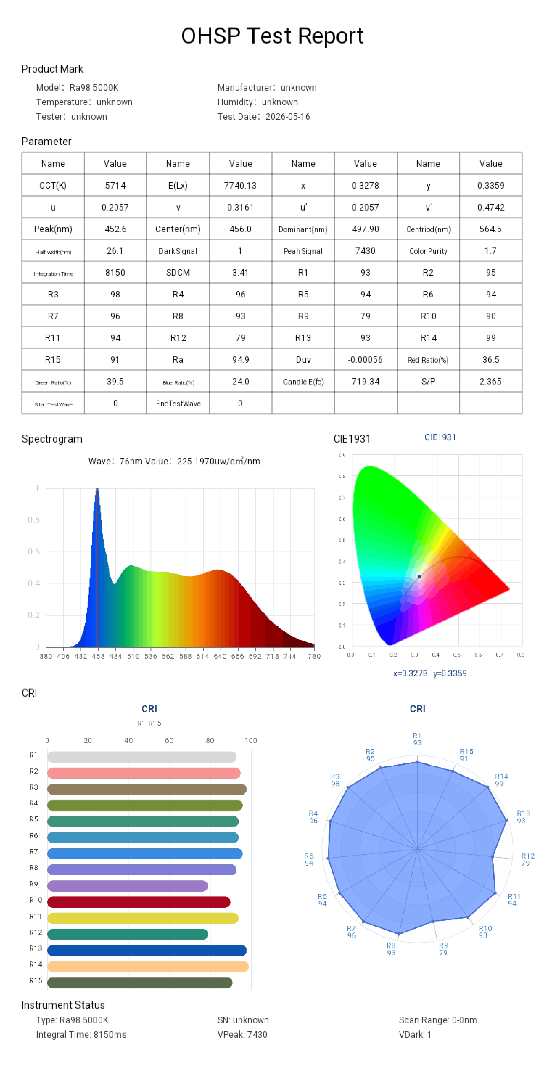

5000K
6000K

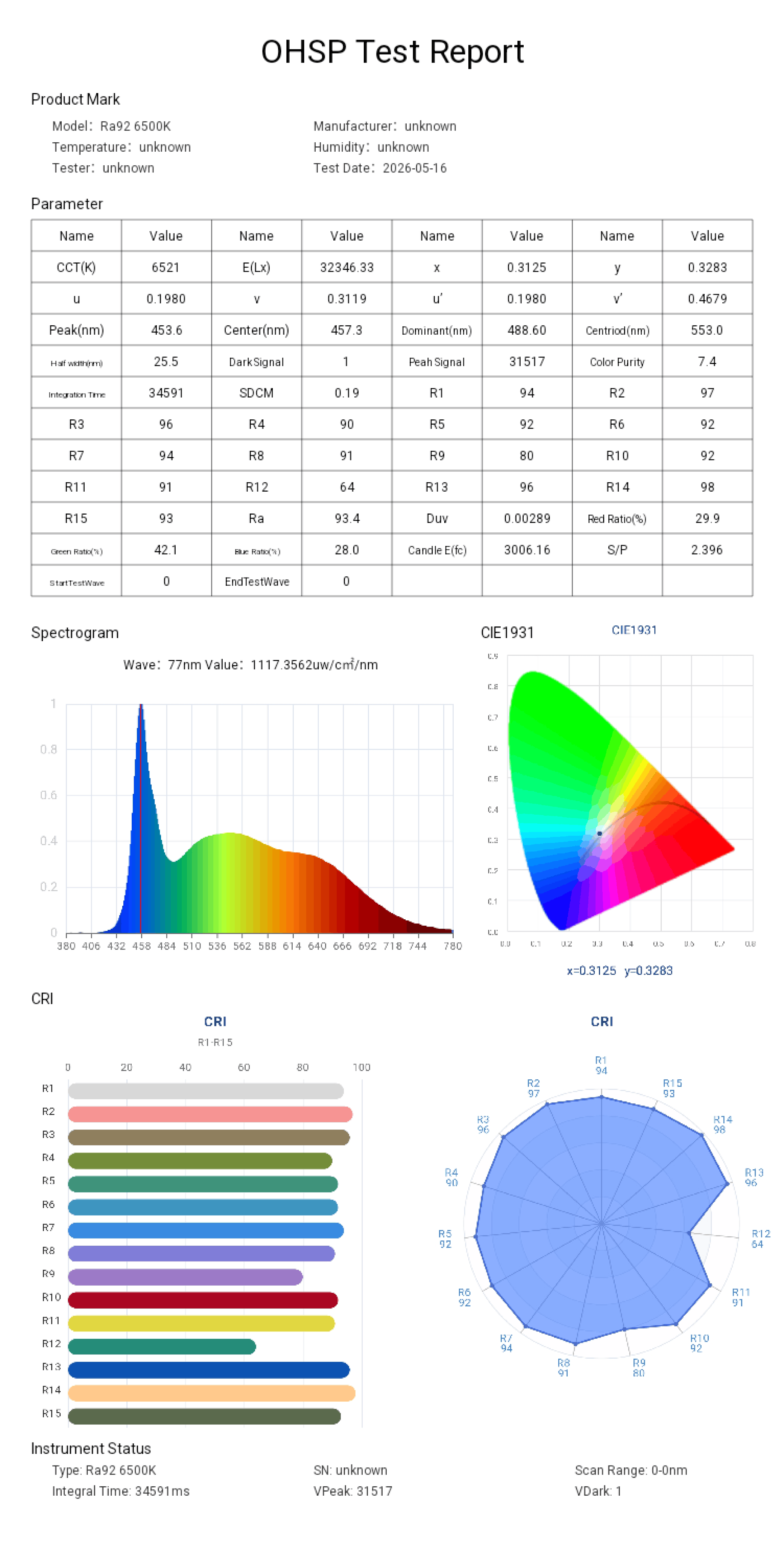

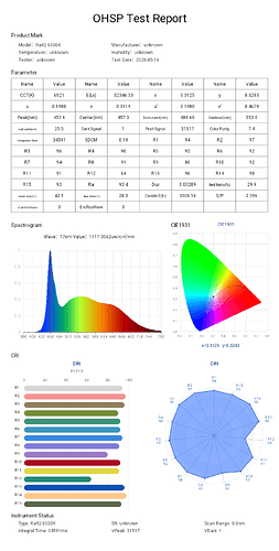

And for comparison, a CRI92 6500K Strip, 3x as expensive but with more than twice the LEDs per meter:
