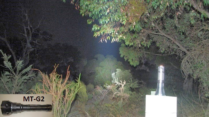

I got these shots done tonight :party:
The sst-90 (dedomed) was bought from DX one year ago and is supposedly 8000k, it’s in an FM 26650 host with FM turbo C head, direct drive single sony lion pulling 14amps at the start.
( BTW here’s some cheap sony cells )
The mt-g2 was bought recently from KD and is 5000k, it’s in a trustfire host modded to fit a DX sst-90 reflector with direct drive 2x ultrafire 26650 pulling 6amps at the start.
I cannot measure light output nor the vf so beamshots are my only reference. Speaking of which I meant to take the TK61vn with me but forgot :zipper_mouth_face:
First up are some ceiling shots. The sst-90 has some rings since the reflector was built for incan. The mt-g2 has some blue around the edge from dedoming.
I tried to zoom in on the far shots but the camera wasn’t co-operating plus the sst-90 light was getting hot and the mozzies were eating me so I called it a night ![]()

Pinkpanda, cool shots, the similarities in the beams is really interesting in light of how differently they are driven. The SST90 appears to preserve the greenery or the scene, while the MTG2 appears to wash out the view, or is that a trick of the camera?
The green color cast of the de-domed SST-90 adds to the greens of foliage. Notice the grey concrete and white/off white buildings…they’re wrong. The MT-G2 is closer to accurate color schemes.
Unfortunately, there is a bit of trickery by the camera. I don’t have a good camera for this type of photography and even if I did I would have to learn how to use it :weary:
The purpose was more about comparing output than colour. The ceiling shots are pretty close to what my eyes see, just slightly less green on the sst and slightly more yellow on the mtg2. The outdoor shots are not quite what I see, particularly the mtg2. I’m not sure but I have a feeling the sst is slowly going green as I didn’t notice it as much before, of course, I may be just thinking that because I’m comparing to the mtg2 now???
