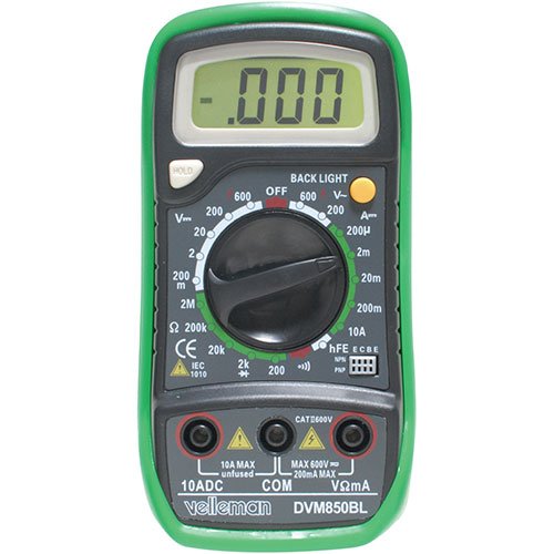

If your interested I have a micro K-type thermocouple you can have. I’ll send it to you for free (with a DMM adapter) if your DMM is capable of reading them. If you’d like it PM me, I can drop it in the mail tomorrow.
Not sure if my DMM can use it or not. Never used one before. My Velleman DMM has an hFE slot, with an 8 pin NPN PNP plug, also says ECBE above it…is that the place? Other than that it’s just got the standard settings on it. It’s a Velleman DVM850BL
Ah, nevermind. Just learned that’s for testing transistors. ![]()
These are what I have, I don’t think either will work with the temp thermocouple. Thanks anyway, nice offer. ![]()
