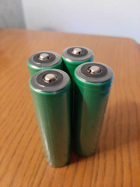

I bought 4 X VTC6 batteries that were installed[In house] with a Stainless Steel BT. Not a solder blob or Third party BT. Liionwholesale will do it for Only $2/battery for any FT you want. They do have several third party BT batteries.

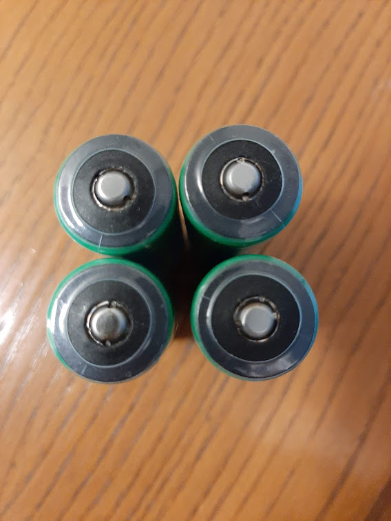

PHOTOS of batteries below. They tested an average of 3027mAh on my Opus BT-C3100 2.2
Depends more on the attachment method than the material itself. You could have a 0.1mm thin metal sheet on top of your contact and if it’s not welded in place then it will create resistance.
It is widely discussed that most batches of 30Q button tops from Banggood are not secured properly with a battery tab welder but just being held with the shrink wrap. It increases IR when tested with a charger and only gets worse at 10 or 20A draw.
For such a small piece, researching which materials offers least resistance is totally overkill. Most of the time it is best to just get the basics right.
