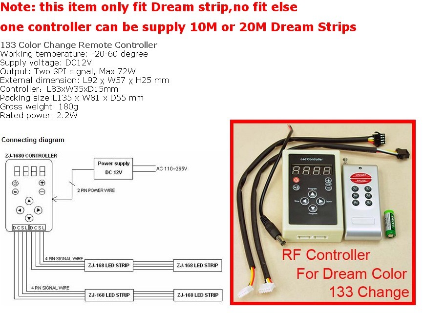

I’ve just started to get into led strips as I’m decorating my car……the kit u posted I have seen and an planing to order but want to know if it is possible to connect to the car battery somehow…… as it has a power pack b 4 the control box how would this b possible as it is mainly for wall sockets…… would I remove the power.pack and attach the cable that goes in to the control box directly to the battery with a fuse added to.the wire……. would I keep the power pack and cut the plug off the power lead and.attack that to the battery or is there a connector I would have to buy seperate. ……., I know it is possible to do.as.I have seen vehicles with the light kit fitted …………n e help on this would b a.great help here’s the link to the kit http://m.ebay.co.uk/itm/131324327224?nav=SEARCH

Welcome to the forum sparliff. Like unit311 said, that control unit should run fine off your car's "12 volt" system. As you suggested, the wall power adapter is not needed. See the wire in the below picture that goes all the way to the top of the picture? You would just wire that into your car's electrical system. Most likely the Red wire would connect to positive and the black negative/ground. The control box should have an indicator as to which post on the jack is positive and which negative. Use that to verify Red is positive and Black is negative.

If you look at the lower part of your ad, you’ll see that you will need to provide this:
