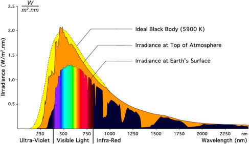

1: Yes, incandescent is 100 CRI 0.000 duv. Sunlight has some evident emission and absorption lines, it isn’t an ideal black body radiator, so, not 100 CRI and not 0.000 duv.
2: A deep red would be all R9, but some other bands will show some value too (R1 (faint red) will measure somewhat high)
Edit: sunlight spectrum for reference.

There may be some distortions to the spectrum due to factors such as impurity of the glass, but an incan spectrum is as close to the ideal 100CRI as you can hope for, and certainly much, much closer than any LED approximation.
