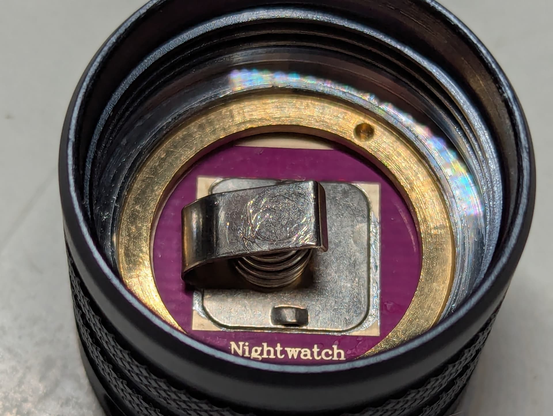

Maybe use something like on my A54 Ultra?
Draws 72A at Turbo if the battery doesn’t say no
How ironic, that is almost the same way old torches were done in the 70’s and 80’s. (But without the spring underneath.)
