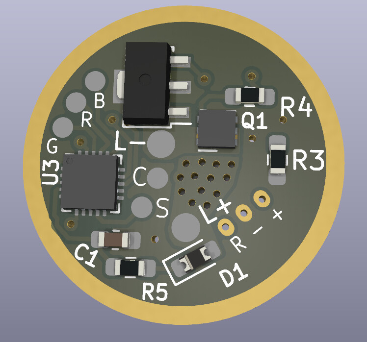

I’ve been working on an FWAA-T1616 1+FET driver that attempts to use as many stock components as possible, only needing a new MCU and FET. It uses the TS10 hex file, though it might need some slight callibration, as the voltage fudge factor is different, so it would be reading 0.1v high
