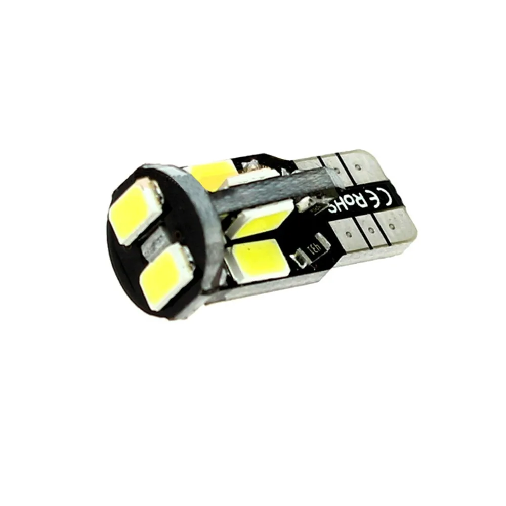

CQD-Light 10 x Error Free T10 led Canbus Led w5w 194 5630 5730 smd t10 10 Smd Light Bulb Car Lamp
They also have a 2pk if you search the store
If you have soldering skills, you can buy those “no Error” things.
If not, they will be dead in hours.
The problem is, that they all have big resistors between positive and negative on them which just burn power - so the bulbs get friggin hot.
Example: 36mm Festoon lamp I bought recently - 2.1W original, 0.7W without the resistor. so 1.4W are just heated away.
This is made so that modern cars don’t give you an error message that a bulb is dead.

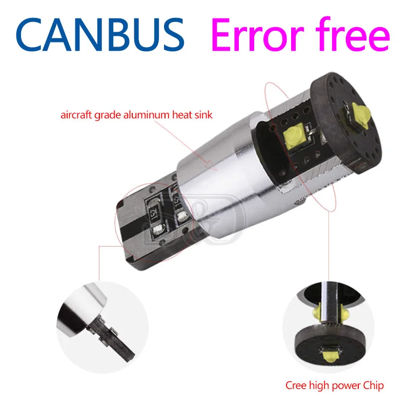

Thanks for the heads up, found this crazy fake cree lamp
any suggestion if I use one of these along with a t10 adapter
I have been running these for several years in my cars as city lights (inside the headlight reflector) No issues with heat.
If you car does not need canbus, just take off the resistor across the power input. The bulbs are not over driven and need no thermal path.

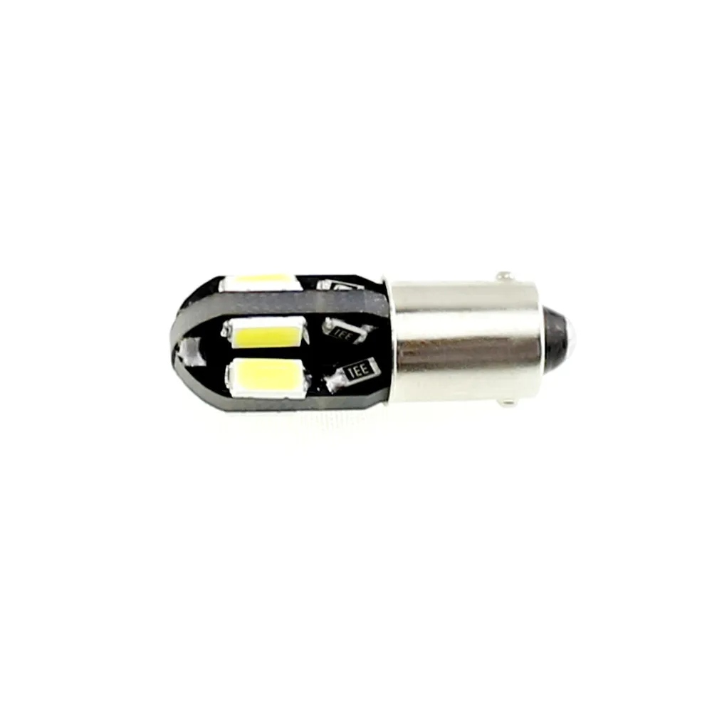

The pic above is just a T10 stuffed inside a BA9S base.
