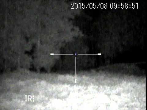

Several months ago i modded Yokon photon 810nm Gen 2 , paired it with a UF1505/SFH47155
The collimator isnt even at its max, those trees are at 200 meters away - the result is realy good i might say
