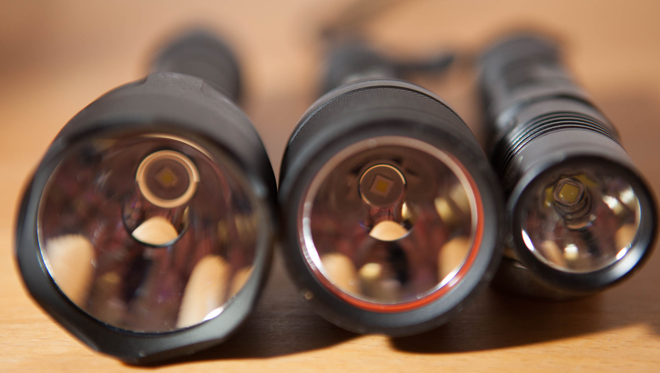

I also got a more pocketable light the Eagle Eye X6 with XPL HI V2-3C
https://www.aliexpress.com/item/Eagle-Eye-X6-CREE-XP-L-HI-V21A-1200LM-4Modes-LED-Flashlight-18650/32446517329.html?spm=2114.13010608.0.0.OSVnyt
Got a nice CC driver with 4 modes plus hidden strobe ant stepdown timer and has AR glass

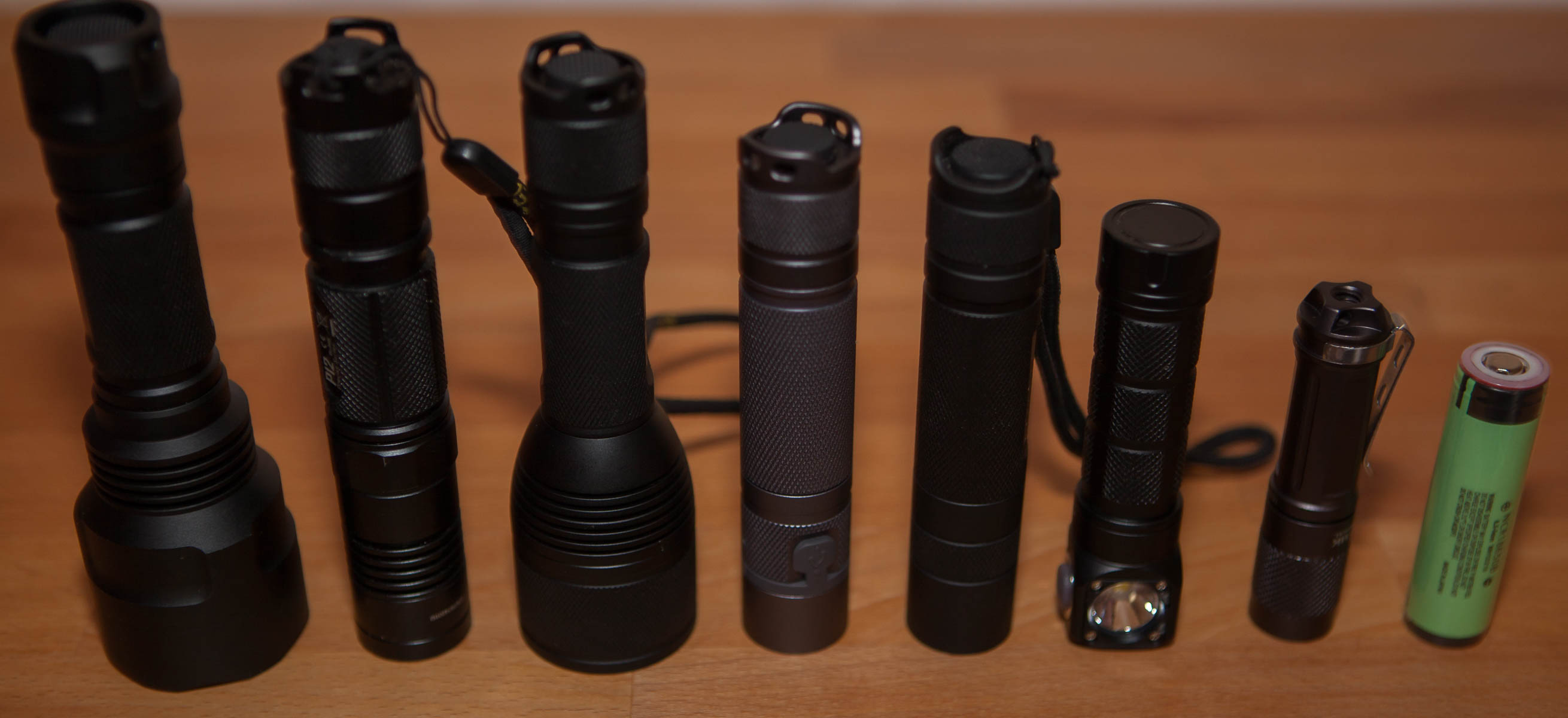

C8 X6 and 1” light
