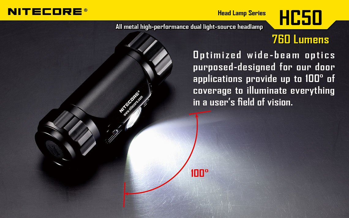

If you rotate the LEDs so they’re in front instead of above, a similar headlamp already exists:
It’s similar, but not really.
First, it’s 18650, so more bulky. For this reason it also needs a 2-strap headband adding to the bulk.
And it has only one white LED, which is less efficient. 6*XP-L2 V6 does 700 lm @ 200+ lm/W. Add a boost driver and such light doubles the sustained output of a 1-led + linear one.
