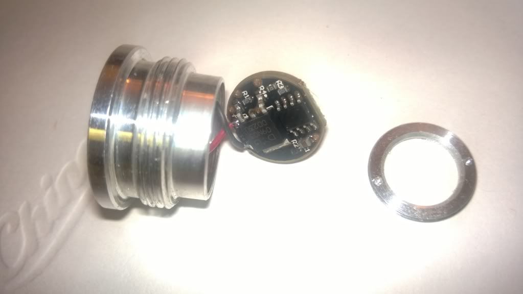

The Clicky is soldered to a board as is the spring which is covered by a brass cap for a plunger style negative contact and is held in place by a heavy threaded retaining. I can't see any problems from this end of the light.
The pill is mostly a typical C8 aluminum pill, but it has an added bonus of a very nice threaded driver retaining ring, no loose negative contacts to this driver. I can't see an problems coming from this section of the light either.

Thanks for the review. As soon as you confirmed the East-92 driver i ordered two more. TangsFire seems to have a good supply of East92s, as they put them in their HD2010s also.

So it is the real East-092 driver? Then I’m gonna order one. I believe a simple swapping of LED into XM-L2 U2 1C on Noctigon will make it screams!
Nice review…
Based on his picture and dmm readings, I would say yes. It looks identical to every east-092 I’ve seen. Though it doesn’t seem to be labeled as east-092, could just be a slight glare in the pic.
It looked like the east 092 was kind of smudged over…but there …and when I compared it to a dead one I had it looked the same. Be right back with a definitive.
The blue color on the board has seemed to cover the east-092 labeling but it is barely legible under the coating. When in the right lighting.
hope that helps
