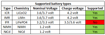

The charger has 3 current settings and can charge up to 26xxx batteries. It can also be used as a usb power bank.

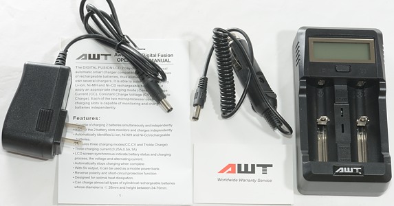

It comes in a cardboard box, the box lists the functions and specifications of the charger.
The box contains the charger, a universal voltage (100-240V 50/60Hz) mains power supply, a car power adapter, a warranty card and a instruction sheet.

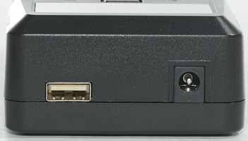

The charger has a DC power connector for the power supply and the car adapter. There is also a usb power output connector.

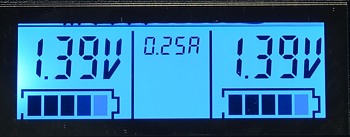

The display shows selected charge current, the voltage with two digits and a animation for charging or discharging when the usb output is turned on. The voltage is shown both when charging and when using usb output.
Thew background light is on while the charger is powered. It can be turned off/on by holding the button down.

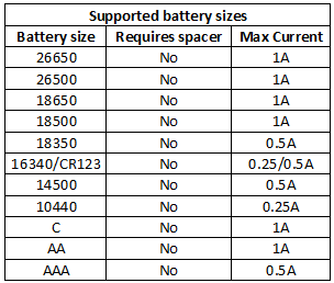

Some of the supported batteries are listed on the space between batteries, but the AAA/AA/C is missing (It is printed on the label on the back of the charger).

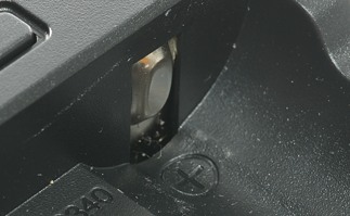

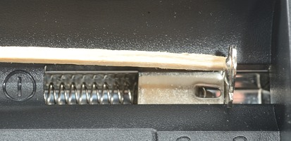

The battery cradle is made the usual way with a slider, it works fairly well, but not as smooth as I could have wished.
Batteries between 29.5mm and 69mm fits in the slot, this excludes some protected 18650 and 26650 cells.
The charger can handle 69 mm long batteries including flat top cells.

- Above 2.0 volt charger assumes LiIon battery.
