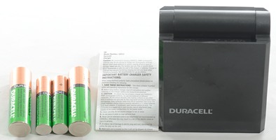

The pack contained the charger, a instruction sheet and some low capacity batteries.

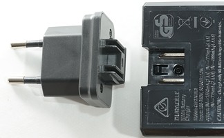

The charger is designed with a replaceable plug, but only one is supplied.

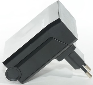

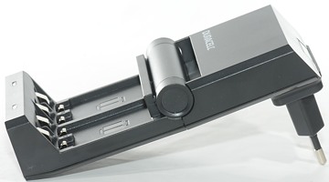

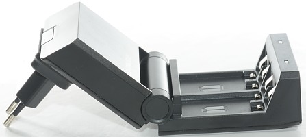

The charger is foldable, it can only charge when open (Batteries will not fit when closed).
The only user interface is two red leds, one for slot #1 & #2 and one for slot #3 & #4, i.e. the charger can only charge two or four batteries at a time.
The led is red while charging and will flash on error. When charging is done they change to green.

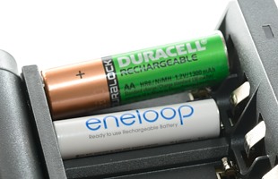

The charger has the typically two level slots used for AA and AAA batteries.

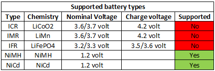

When a charger like this says it’s for both NiCd and NiMH — does it treat them differently? How can it tell them apart?
There is no reason to treat them differently, as long as the charger can handle NiMH, it will also handle NiCd.
