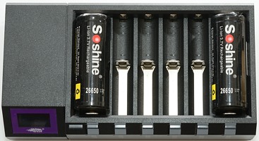

This is a 6 slot LiIon charger with 3 charge current from 0.5A to 2A (Only for two cells).
The charger comes in a cardboard box without much information on, but it has a comic on the back. I got the mains lead in a separate box.
The power input socket is universal voltage (100-240VAC 47-63Hz).
The charger included the charger, a mains lead, a user manual and a warranty card.

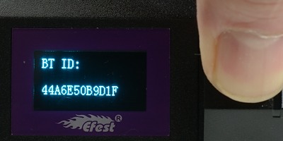

Bluetooth id, this is only needed if you have multiple chargers and want to get the correct one connected to the phone.

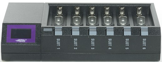

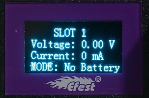

Usual the display will change between the six slots, showing the status.

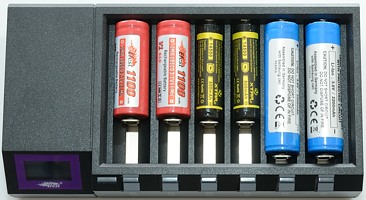

The charger has 7 buttons, one for each slot and one for general functions (Like changing current for selected slot, turning the display off and showing the Bluetooth id). The other six buttons are used to select a slot. The button interface is a bit fiddly, because the charger can be a bit slow to response.
While charging the buttons are flashing blue, this will change to steady blue when the battery is full.

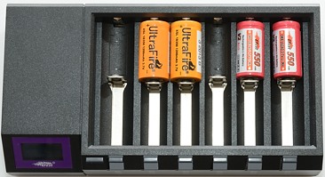

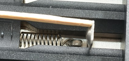

The charger uses the usual slider construction and support from 32.6mm to 71.6mm, this means even long protected cells are supported.
The low current setting is a bit high for 10440. The charger can handle above 71mm long cells, with both flat and button tops cells.

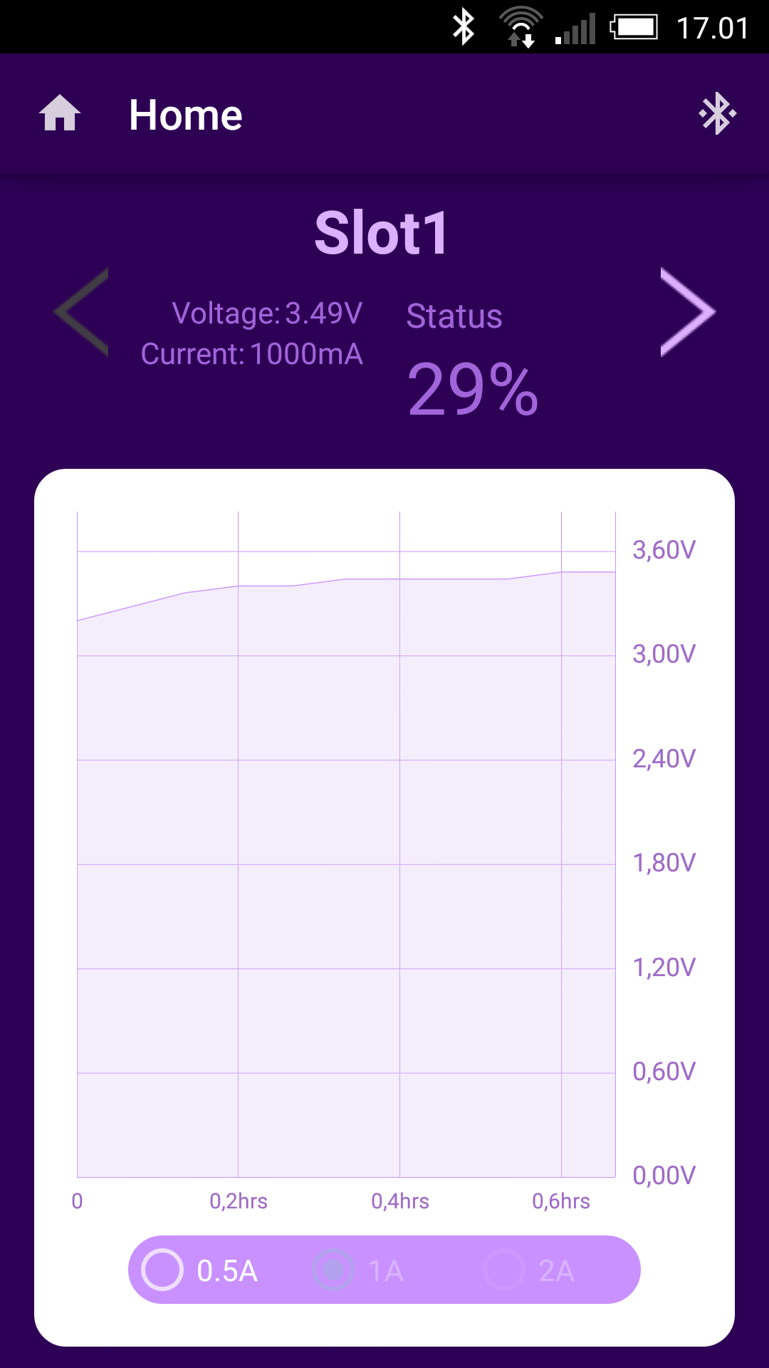

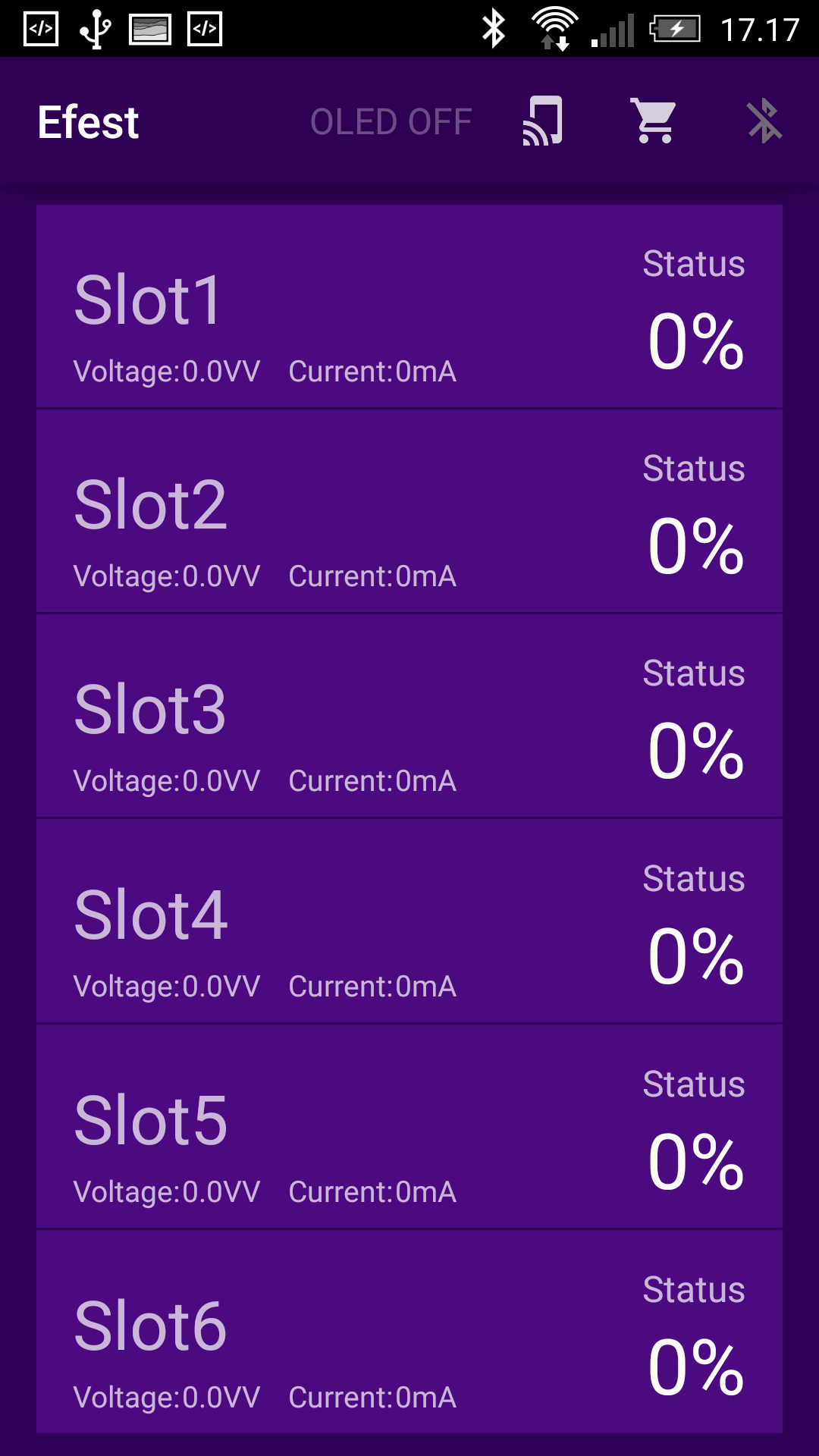

Phone interface
The charger can be linked to a smart phone, I have tested with a HTC One A7.

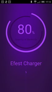

While starting the phone shows a percent count, then it goes to the slot view, the one shown here is when no charger is selected.

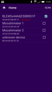

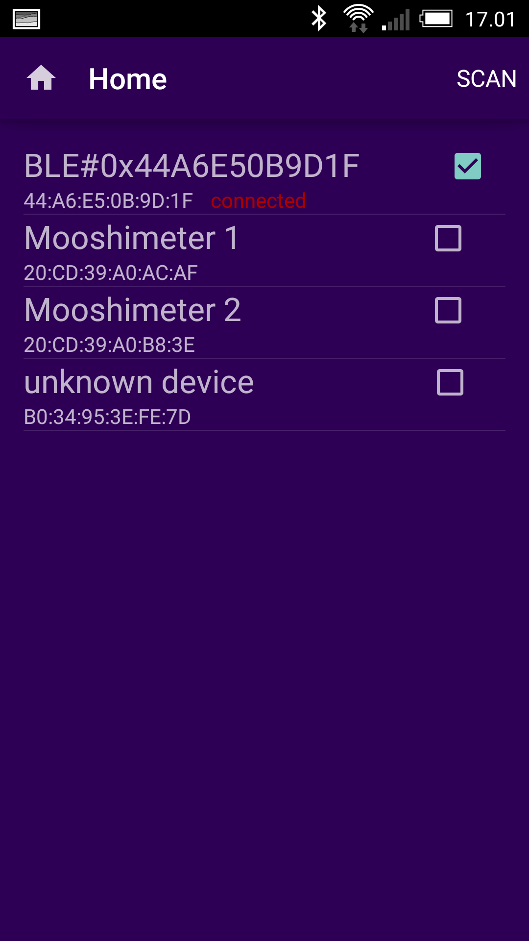

Press the icon on the top line to select a charger, the phone will automatic search for available Bluetooth devices.

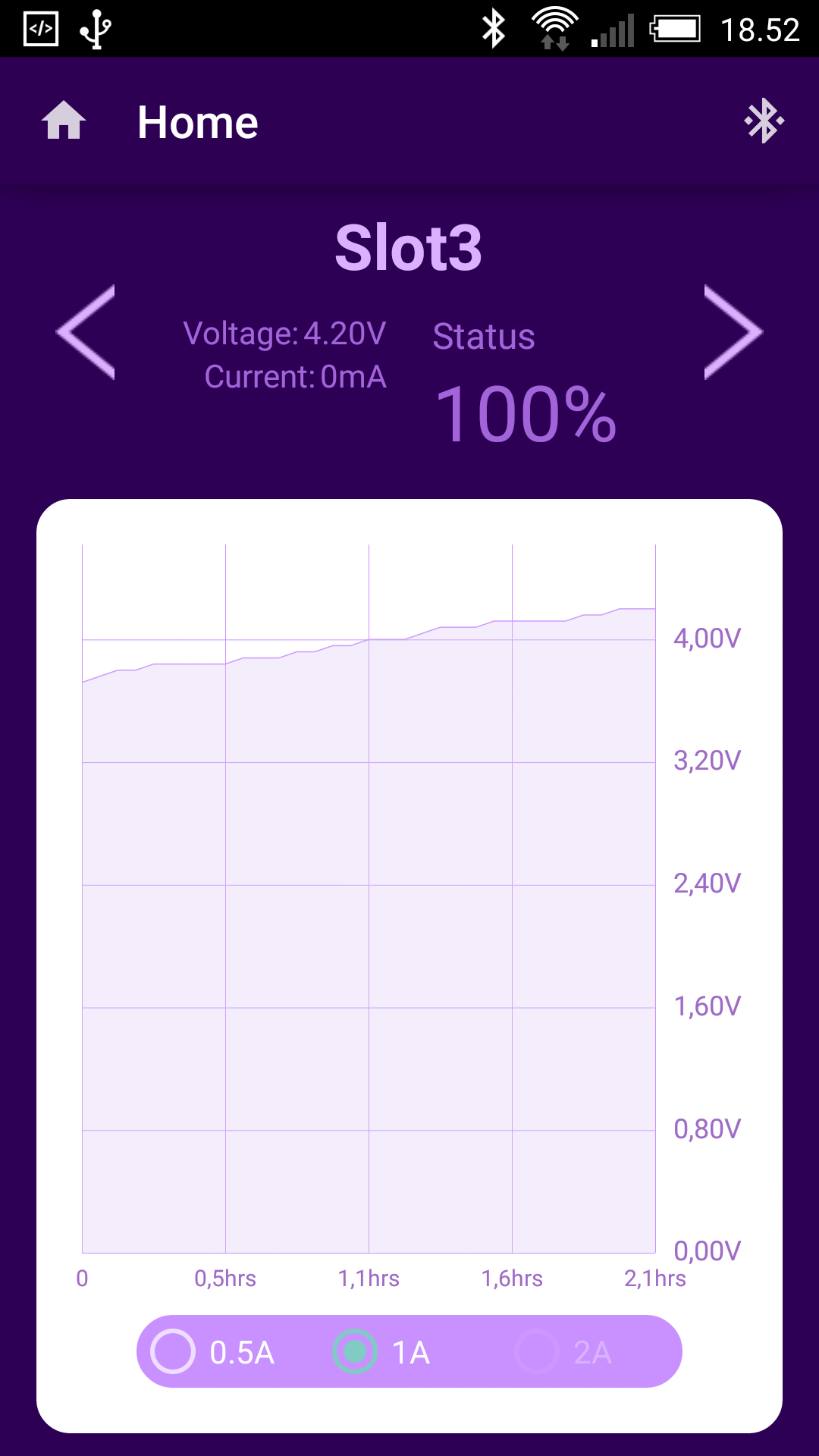

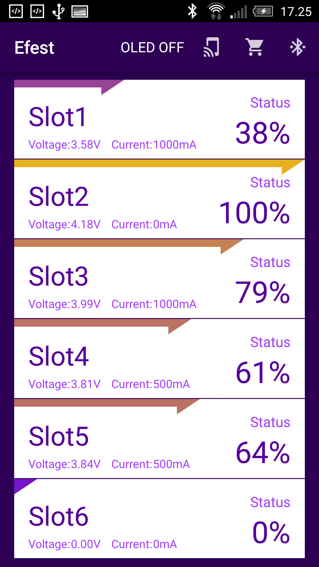

Here the slot view is shown while charging, tapping on any of the slots will show a status for that slot, where it is possible to select charge current. Charge current can be changed at any time during charging. It looks like the charge curve is stored in the charge, the app do not need to run during charge to get the full curve.
The “OLED OFF” text can be tapped to turn the display on the charger off or on again.
