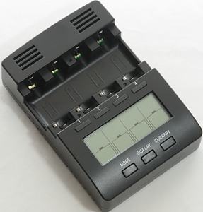

I got this analyzing charger from DX, it has more modes than the typically analyzing charger.

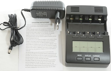

I got the charger in a retail box.
The box contained the charger, a power supply and a instruction manual.

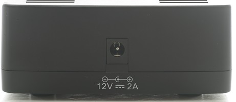

The charger uses a external 12V power supply.

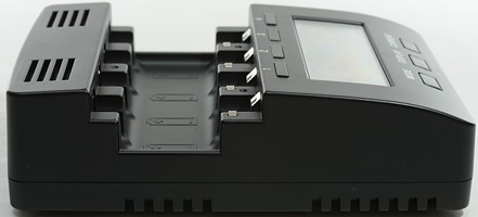

The user interface is a display and 7 buttons.
The buttons numbered 1 to 4 must always be used to select a slot with, before parameters for that slot can be changed. It is possible to select a slot and change mode when it is working.
Mode is used to change between the different modes.
Display is used to change parameter to display, it can also be used to change between adjustable parameters.
Current changes charge current or charge time for timed charge.
With one or two batteries the charger current can be 200, 500, 700, 1000, 1500mA, with more batteries the 1500ma current is disabled.
Discharge currents are: 100, 250, 350 and 500mA

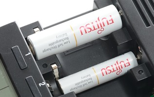

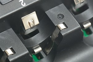

The charger uses the usual two level slots for AA/AAA cells and it looks like it has a temperature sensor for each battery.

Using my 12V power supply the charge looks much more realistic.
I.e. the supplied 2A power supply may be faulty/weak (I did not use any time on analyzing it).
