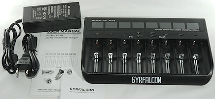

Enova has updated their universal 8 slot charger.
The cardboard box lists a lot of specifications for the charger.

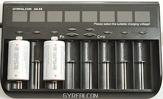

The box included the charger, a power supply, some accessories for special battery sizes and a instruction sheet.

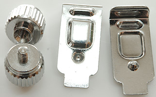

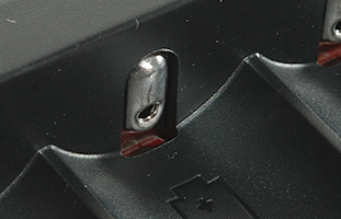

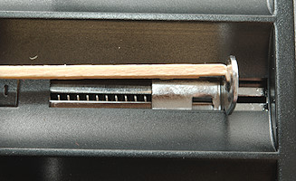

The accessories are spacers for handling small batteries and some extensions for the plus connection for handling C, D and 32xxxx size batteries

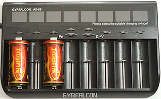

The extension in use.

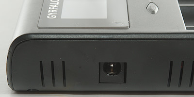

The DC input is the usual barrel connector and it is rated for 12V input at 4A.

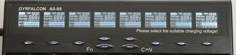

The display has many elements on it, because the charger can handle many types of cells.
One this image the charger is in automatic mode, i.e. it is not possible to select voltage, that will be done automatic and only NiMH and 4.2V LiIon can be charged. (Hold down Fn and CV for some time to switch between manual and automatic)
In manual mode it is possible to select both voltage and current for each slot:
Press button for slot to select it.
Press button for slot again to select voltage.
Press CV to select current setting.
Press button for slot to select current.
Press CV to select voltage setting again.
Hold button for slot down to start charging.

The C.A line shows selected current and is also used to select current when the “>>” marking is at this line.
The V.V line shows selected charge voltage and is also used to the select voltage when the “>>” marker is flashing at this line.
The battery icon is animated when the charger is charging.
The display will automatic dim after some time, any button press will bring it back to full brightness.
In this image adjustment of current is select (>> is at the C.A. line).

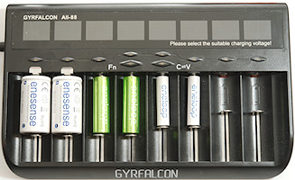

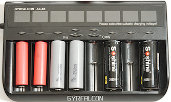

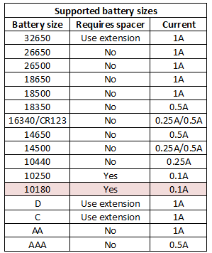

The sliders work very smooth and can handle from 30.2mm to 71.7mm, up to ø26mm cells can be placed in each slot and it is possible to use ø32mm cells in each other slot when the extension is used (Only two supplied). For NiMH extension must be used for both C and D cell.
Due to the wide slots, care has to be taken with thinner batteries to get a connection.
Using the “Extensions” both C and D cell can be charged.
With 10180 cell the 100mA charge current is on the high side, but because most 10180 are high current cell it will usual be acceptable.
C, D & 32xxx cells can have trouble with the plus connection, using the small extender will fix this.

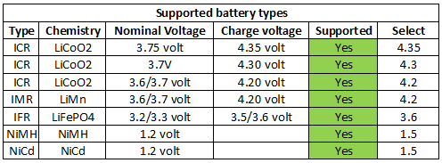

Charging 4.35V LiIon cells
The charger supports both 4.30V and 4.35V cells, I only did a test with 4.35V and it looks fine.

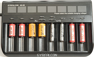

Charging 3.6V LiFePO4 cells
The charger charges LiFePO4 to 3.6V, but the restart voltage is too high, i.e. the charger will restart a couple of times after it is finished.
