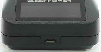

The micro usb connector for power input is placed on the front, just below the display.

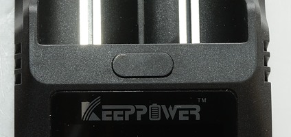

The user interface is a display and a single button.
A press on the button will change between 500mA and 1000mA charge current, but only when there is a battery in the charger.
Holding the button down will turn off the display and disable the current change function, the charger will continue to charge with selected current. To turn display on again the button must be held down again.

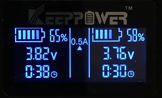

The display has an animated battery icon, charge percent, voltage and selected current for each channel.

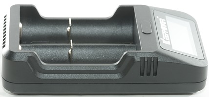

The charge uses the typical slider construction with a metal rail and it works smoothly from about 29.7mm to 70.9mm, i.e. the charger can handle nearly any 18650 and 26650 cells both protected and unprotected.
The charger can handle 70.9 mm long batteries, including flat top cells.
