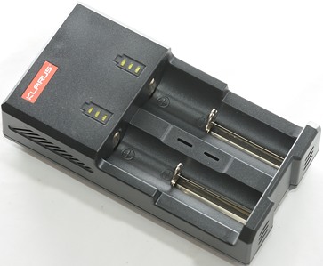

This is a simple dual channel charger from Klarus with support for both NiMH and LiIon. It can also be used as a power bank.
I got the charger in a retail cardboard box from a gearbest. The box has the specifications printed on the back.
The box contained the charger, a mains cable and a instruction sheet.

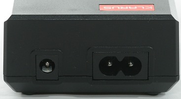

The charger has both a mains power input socket and a 12V DC input barrel socket.
The charger can works as a power bank. With one LiIon battery it is rated for 1A and with two LiIon batteries it is rated for 2A.

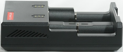

The charger do not have much user interface, only 3 yellow leds for each battery. When charging one of the leds for each battery will flash and the number of lit leds will show the actual charge status. When finished all 3 led will be steady lit.

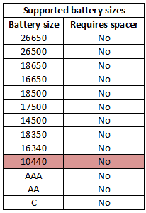

The charge uses the typical slider construction with a metal rail and works from about 30mm to 69.3mm, i.e. the charger cannot handle the longest protected 18650 and 26650 cell.
The charger can handle 69.3 mm long batteries, including flat top cells.
The minimum charge current is 0.5A, this is on the high side for 10440 cells.

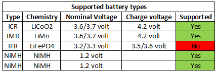

- Between 0.7 volt and 2.0 volt the charger assumes NiMH
- Above 2.0 volt the charger assumes LiIon
