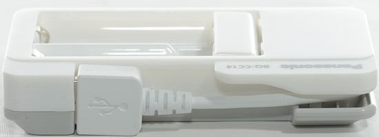

The Panasonic contents was: The charger, 2 Evolta cells and a instruction sheet in many languages.

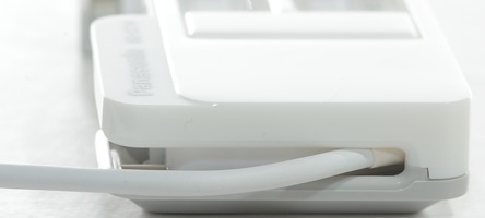

The usb plug is folded around the charger and is easy to take out.

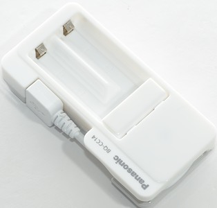

The charger has one hidden led to show charge status. It is flashing when charging and steady lit when done.

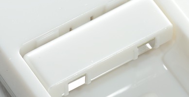

The charger has a tiltable spacer that can change the length of the slots between AA and AAA.
This design means the charger can either charge AA or AAA, not both AA and AAA at the same time.

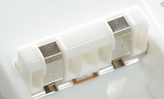

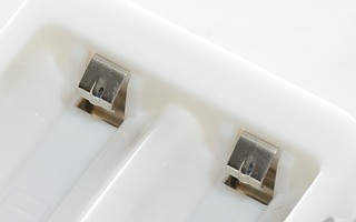

There are some springs in the other end of the slots.
