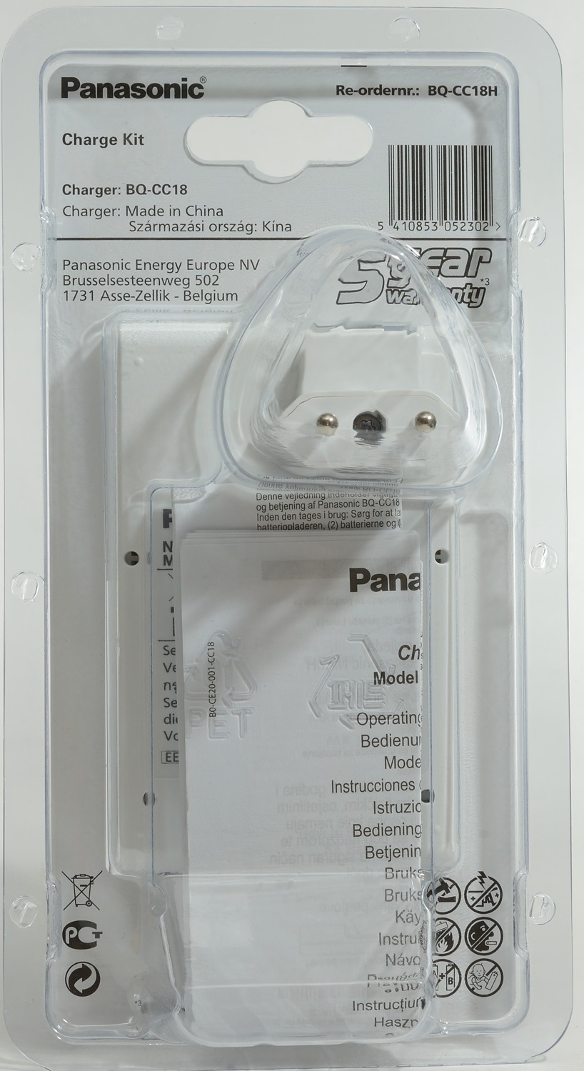

I found this charger on ebay from akkuland.
I got the charger in a blister pack. There was no extras, only the charger and a instruction sheet.
The instruction sheet specifies charge time for different cell capacities, from 5 hours for a 1000mAh AA to 12 hours for a 2500mAh AA.
The charger is designed with a foldable US plug.
But when sold in EU a EU plug is clicked on above it.

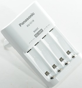

The only user interface is two leds, one for slot #1 & #2 and one for slot #3 & #4, i.e. the charger can only charge two or four batteries at a time.
The leds is green while charging and will flash on error. When charging is done they turn off.

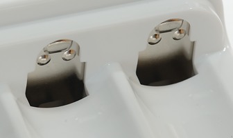

The charger has the typically two level slots used for AA and AAA batteries.
