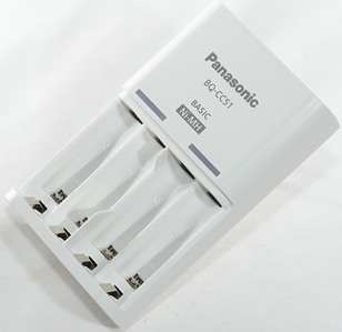

Panasonic has a line of NiMH chargers, some are fast and smart, others dumb. This one here is a very slow and rather dumb charger. I got the charger together with the latest revision of Eneloop, they are tested separately.
I have tested this charger before, but Panasonic asked me to test this E version (I do not know if E is European or a new revision of the charger).

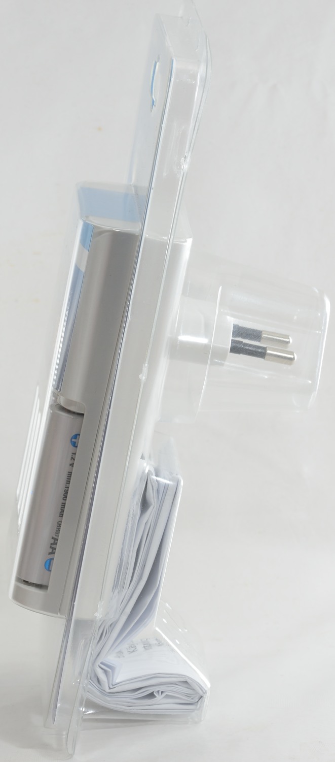

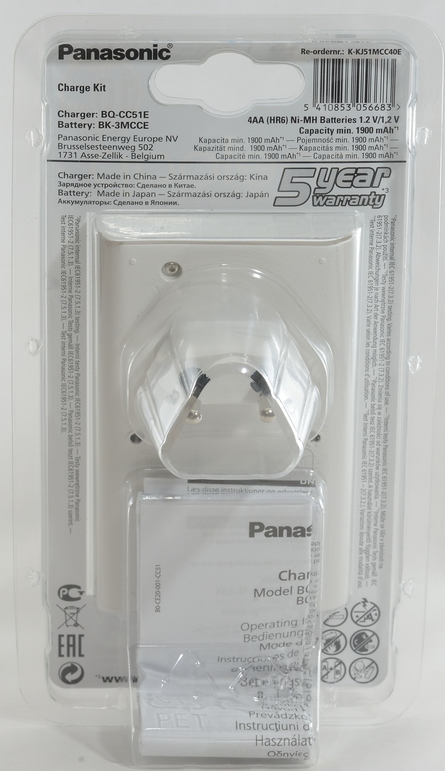

I got the charger in a blister pack. There was the charger, 4 eneloop batteries and a instruction sheet.
The instruction sheet specifies charge time for different cell capacities, from 5 hours for a 1000mAh AA to 12 hours for a 2500mAh AA, you are supposed to remove the batteries after that time.
The included batteries are Eneloop AA BK-3MCCE 1900mAh.

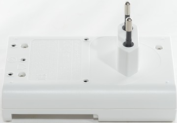

The charger is designed with a EU plug.

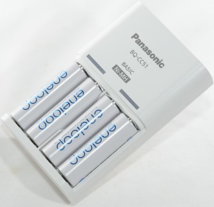

The only user interface is two leds, one for slot #1 & #2 and one for slot #3 & #4, i.e. the charger can only charge two or four batteries at a time.
The leds is green while charging and will flash on error. When charging is done they turn off.

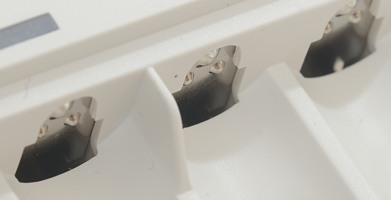

The charger has the typically two level slots used for AA and AAA batteries.
