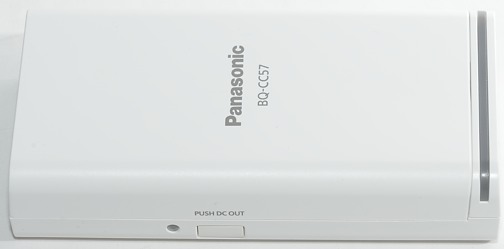

Charger Panasonic BQ-CC57
Panasonic has a line of NiMH chargers, some are fast and smart, others dumb. This one here is fairly fast smart charger with power bank functionality.

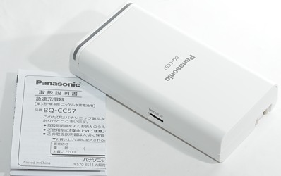

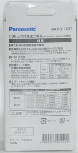

I got the charger in a blister pack.
The pack included the charger and a fairly long instruction sheet. Not the usual multi language one, only Japanese (I assume), with a lot of explanation on.

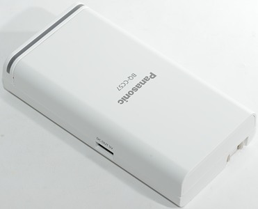

The charger has a foldable US plug.

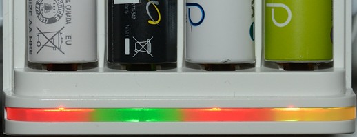

The charge status indicators are more than just a red/green led, they start from red and slowly changes to green while charging (A bargraph would have been more practical, but not looked as fancy).

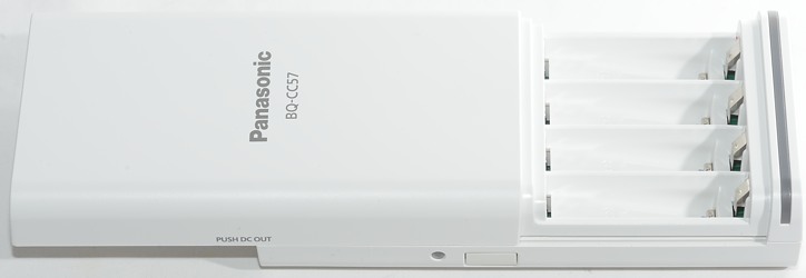

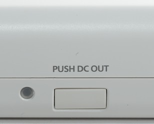

The charger has a usb output, it will work both as power bank and as usb charger. The button must be pushed to turn the usb output on, the green led beside the button will be on when usb power is on.

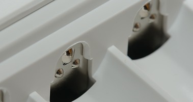

The charger has the typically two level slots used for AA and AAA batteries.
