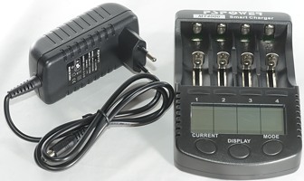

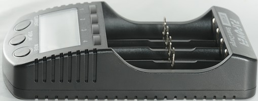

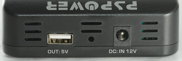

The charger has a 12V input for the power supply and a usb output.

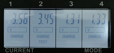

The charger has a lcd display to show functions and charge status and 7 buttons.

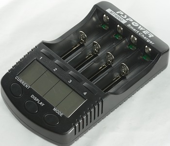

The 1-4 buttons is used to select a single slot, where mode and current can then be specified.
The MODE button is used to charge or test, when used without a number key it will set for all slots, if a number key is pressed first then only the mode for that slot is changed.
The CURRENT button will select current for the slot that has just received a battery or has just changed mode.
The DISPLAY button selects what to display.

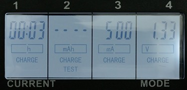

The display can show mA, mAh, volt, hours and ohm, use the DISPLAY button to select.

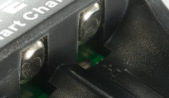

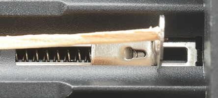

The charger has the usual sliders and they can handle from 32mm to 70.3mm, this means most cells, except the longest protected 18650 and 26650 cells.

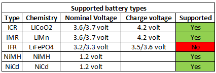

Between 0.1A and 1.5V the charger assumes NiMH
Between 1.6V and 2.2V the charger will not recognize a battery.
Above 2.2V the charger assumes LiIon

Usb output
Usb output is coded as Apple 2.1A, but the coding may be out of tolerance.
It is not a power bank
The usb output can deliver 1.1A, that is fine for a 1A rated output. The efficiency is rather low.
The output can deliver 1A for one hour.
