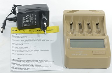

I got the charger in a cardboard box with lots of information on.
The box contains the charger, a power supply and a instruction sheet.

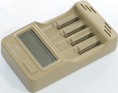

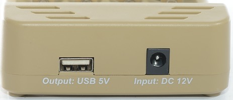

The charger has a barrel connector for 12V power input and a usb output connector for power bank function.
The user interface is a display and a single multi-function button.
Fast presses on the button will change the display between hour:min and capacity display.
Holding the button down for two seconds will change the current one step (300/500/700/1A) for all slots.
Holding the button down for 5 seconds will select LiFePO4 for all slots.
First display shows normal charging with 300mA, one LiIon and two NiMH cells.
The second displays shows that the power bank function has been activated (it will not stay on).

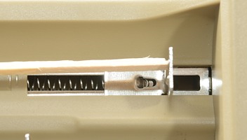

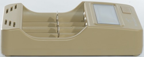

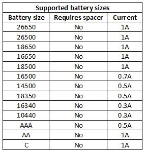

The charger uses the common slider construction and will handle batteries from 31 mm to 71 mm, this means just about any cell.
The charger exist in both the usual black and a sand colored one.
