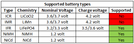

Soshine makes a couple of chargers of varying quality, this charger is a single channel charger for NiMH and the LiIon type called LiFePO4 or IFR (This is clearly marked on the charger), i.e. it cannot be used for the LiIon batteries that needs 4.2 volt charge, but only for LiIon batteries marked 3.0 or 3.2 volt. The charger is very limited in battery size and must be powered from usb.

The charger charges to 3.7 volt, not the usual 3.6 volt and it restart when the voltage drops after charging.
