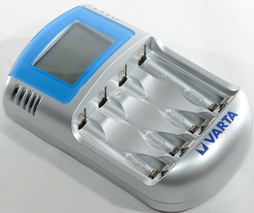

Varta makes both batteries and chargers, here I am looking on a four channel charger with a LCD display.
I got the charger in a blister pack. As can be seen on the pack the charger needs two hours to charge batteries, but is this correct?

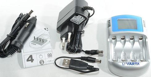

The pack contained the charger, a power supply, a car adapter, a usb adapter and a instruction sheet.

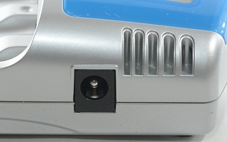

This unmarked connector is for 5V and 12V input (The label on the bottom of the charger says 5V and 12V). The charge current is reduced with 5 volt input.

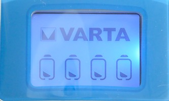

The user interface is a LCD display with four battery symbols.
With no batteries in the charger no battery symbols are shown, while charging animated symbols are shown and when full filled symbols are shown.

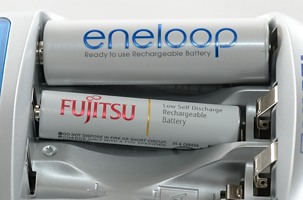

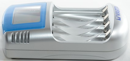

The charger has the typically two level slots used for AA and AAA batteries.
