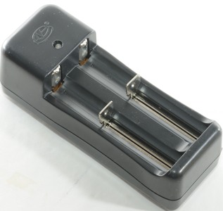

Charger Xiamen Nanfu HG-1206W

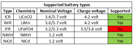

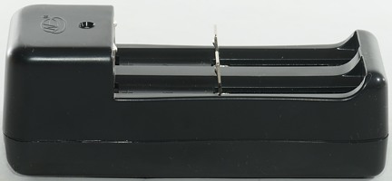

This charger is a very cheap multi LiIon chemistry charger that supports a wide variety of LiIon and NiMH sizes.
The charger is powered from the mains and is universal voltage (100-240 VAC 47/63 Hz). It has a foldable EU plug and it does not fit modern outlets where the holes are below the surface of the outlet.
The charger has one led, that will be red when charging and green at other times.

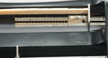

The charger uses the usual slider constrution and support from 30mm to 69mm, this means it will not support long protected 18650 cells.
The charger can only handle up to 69mm long cells, with both flat and button tops cells.

Above 2.9 volt LiIon is assumed.

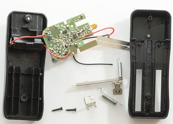

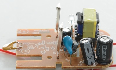

I had to remove two screws, then I could open it.

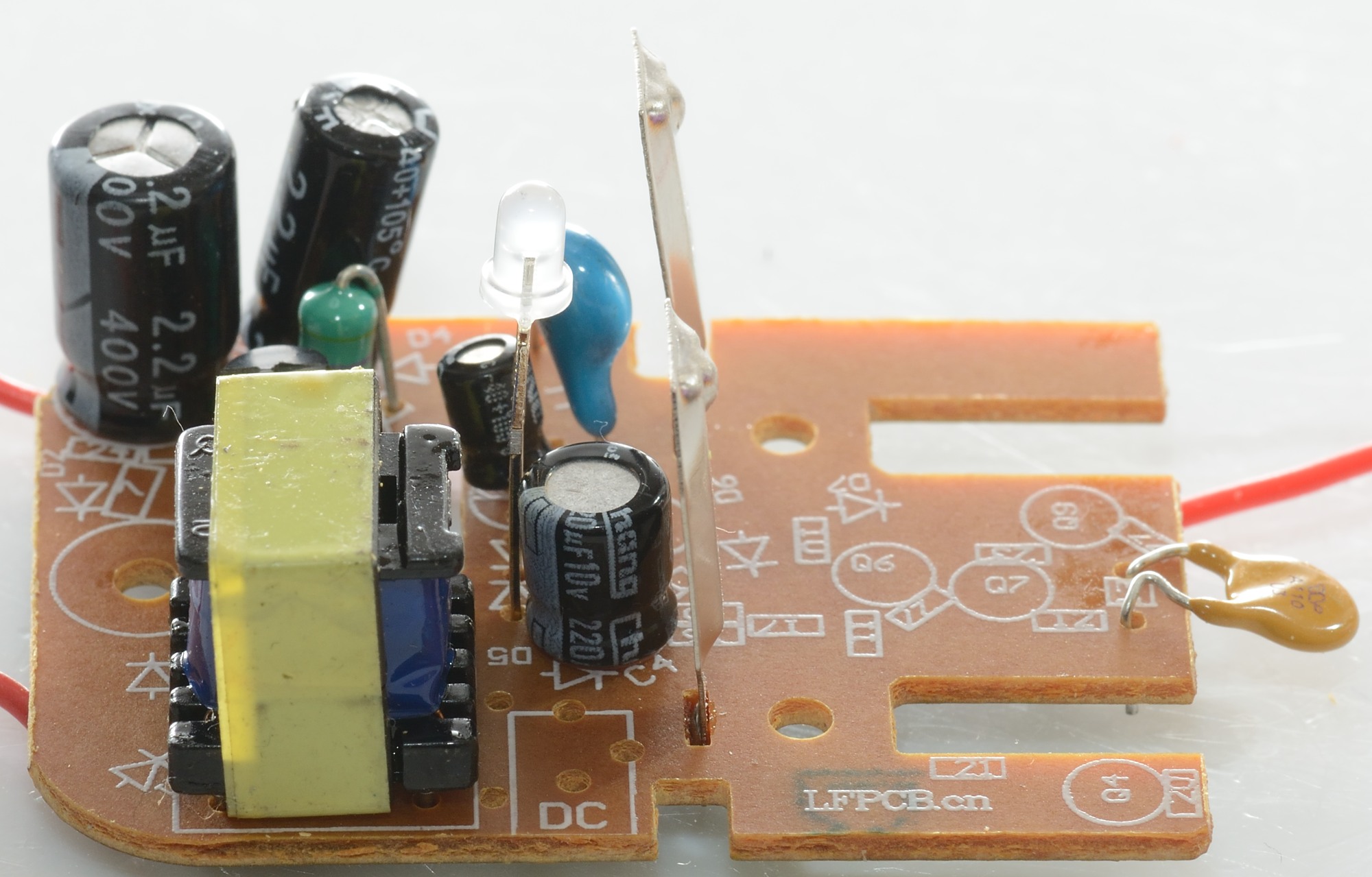

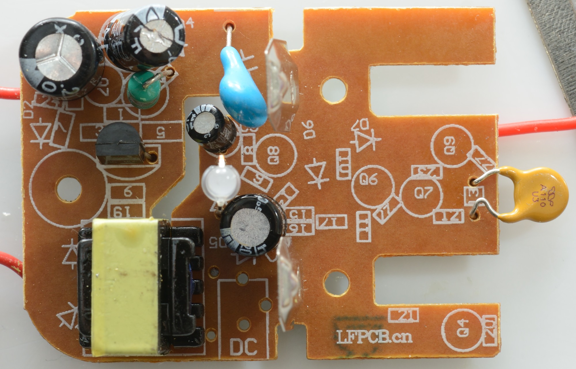

There is not many interesting parts. There is a safety capacitor.

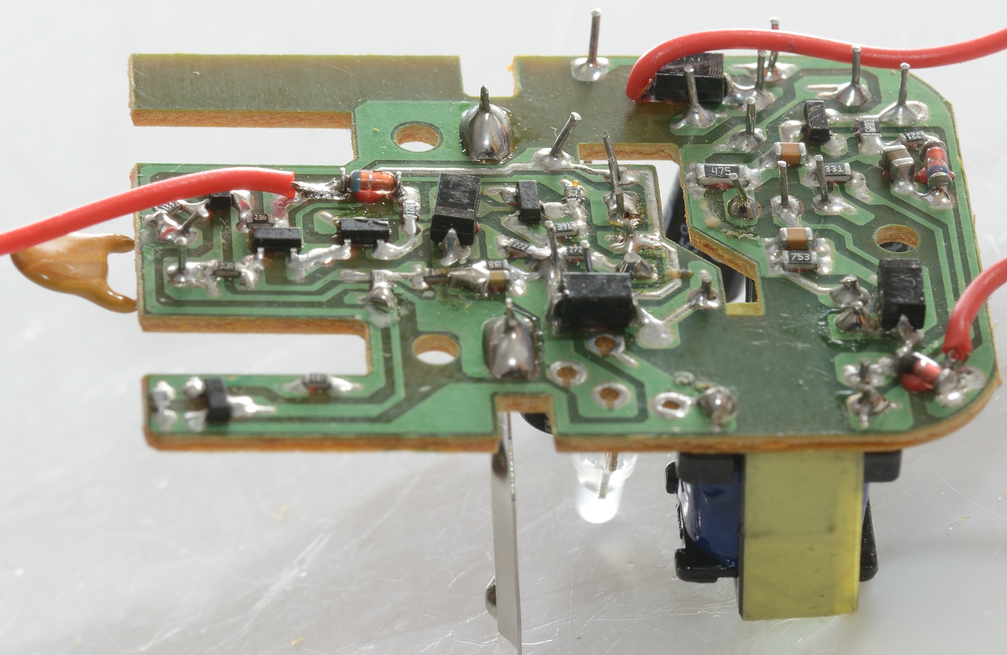

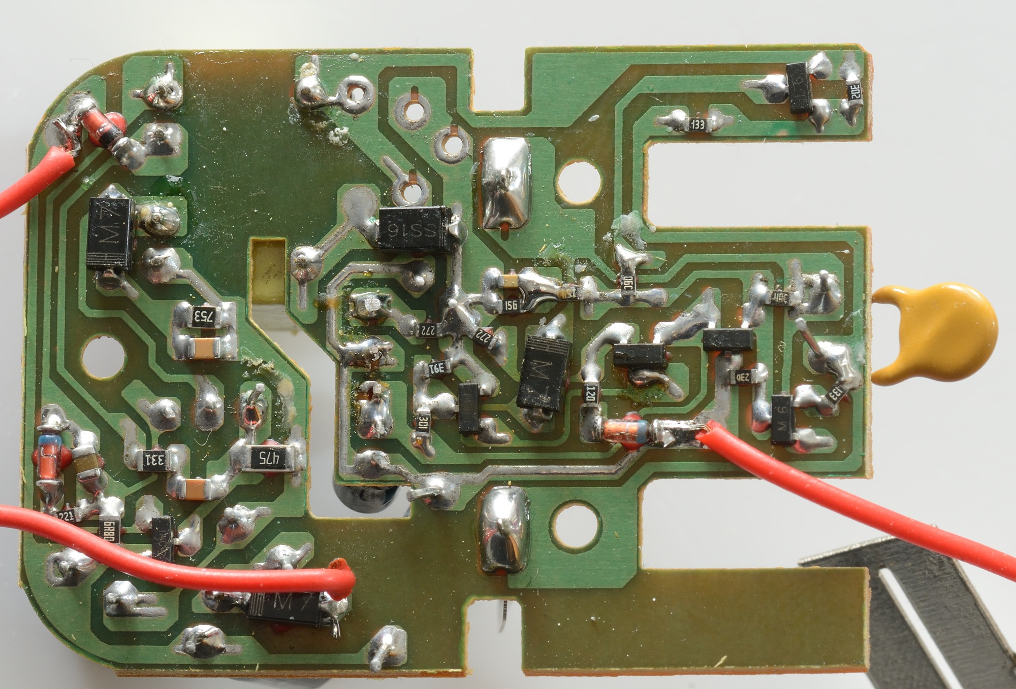

The mains switcher is a single transistor, there is no IC to control it.

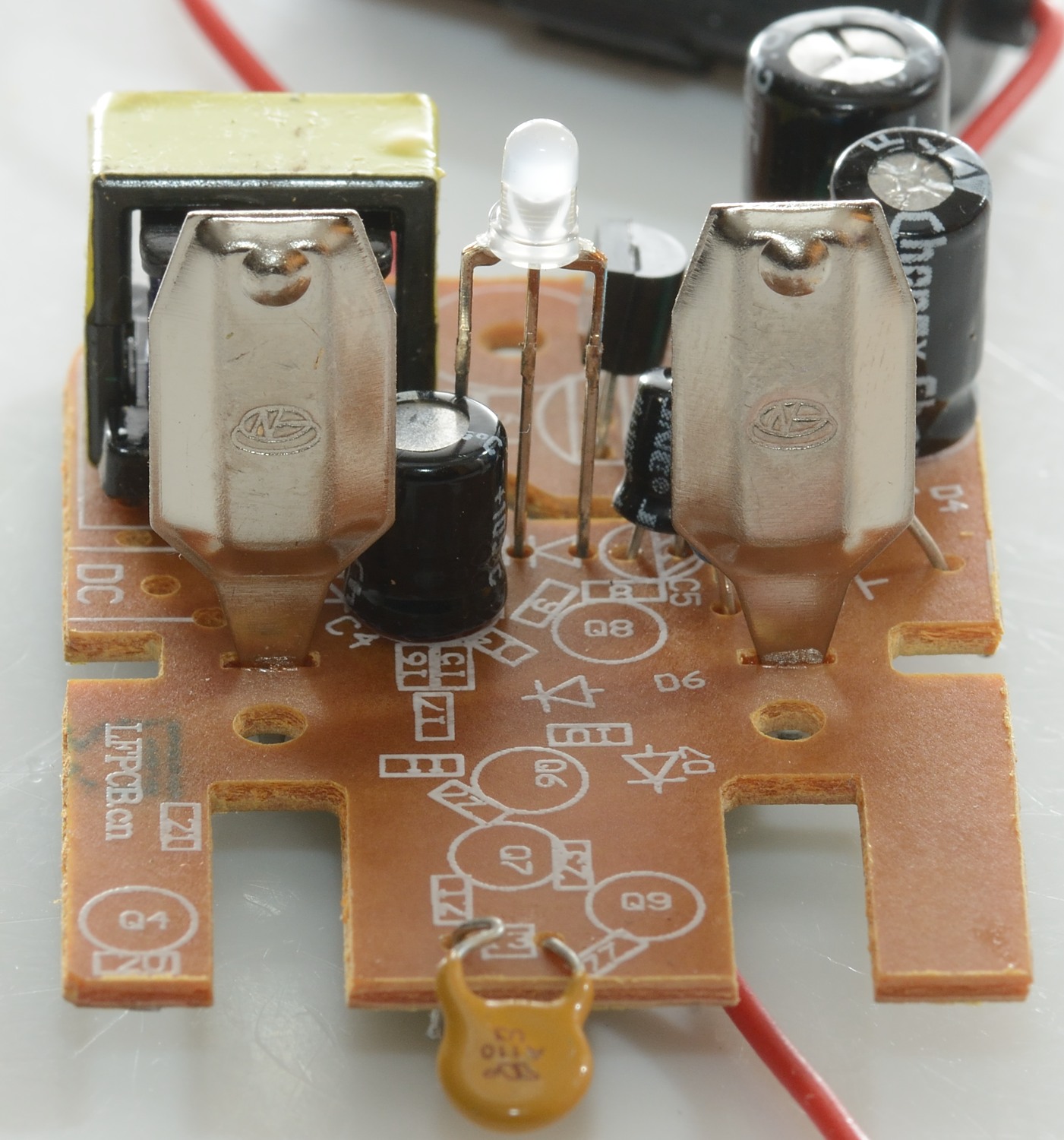

All the parts drawn on the circuit board is placed on the other side.
Diodes and a few transistors to control the charger. The slot in the circuit board do improve the safety, but not enough.
It looks like the yellow disc is used to link the two charge slots together.
The charger passed an isolation test with 2500 volt, but failed a 5000 volt test.
