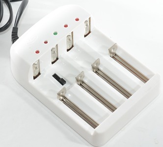

This charger is a fairly cheap multi chemistry charger that supports a wide variety of battery sizes.
The charger is delivered in a retail box with both Chinese and English text on it.
The charger has a fixed mains cord and is universal voltage (100-240AC).

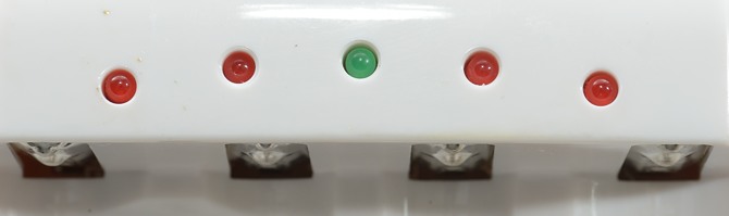

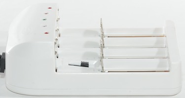

The charger has one led for each slot and a common led that shows when power is connected.

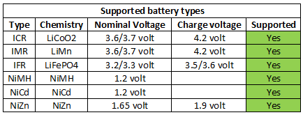

Selection of chemistry is done with a slide switch it is marked:
1.2V for NiMH
1.5V for NiZn
3.6V for LiFePO4
4.2V for Normal LiIon
The text beside the slider is rather difficult to read.

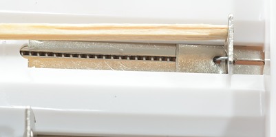

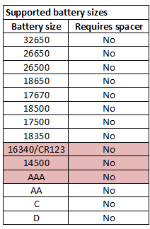

The charger uses the usual slider constrution and support from 28mm to 69mm, this means it will not support long protected 18650 cells.
The charge current is a bit high for small cells. The charger can only handle up to 69mm long cells, with both flat and button tops cells.

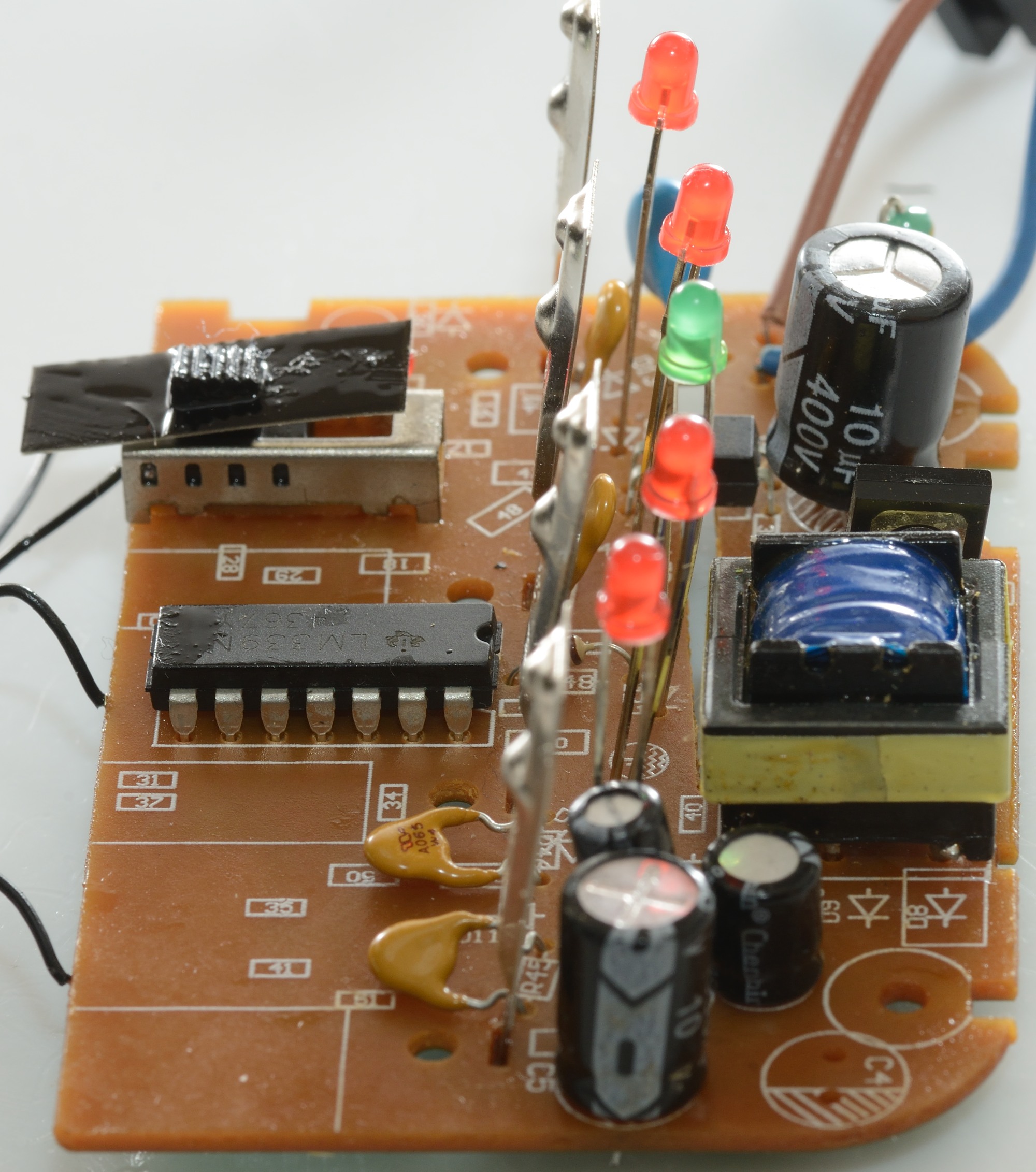

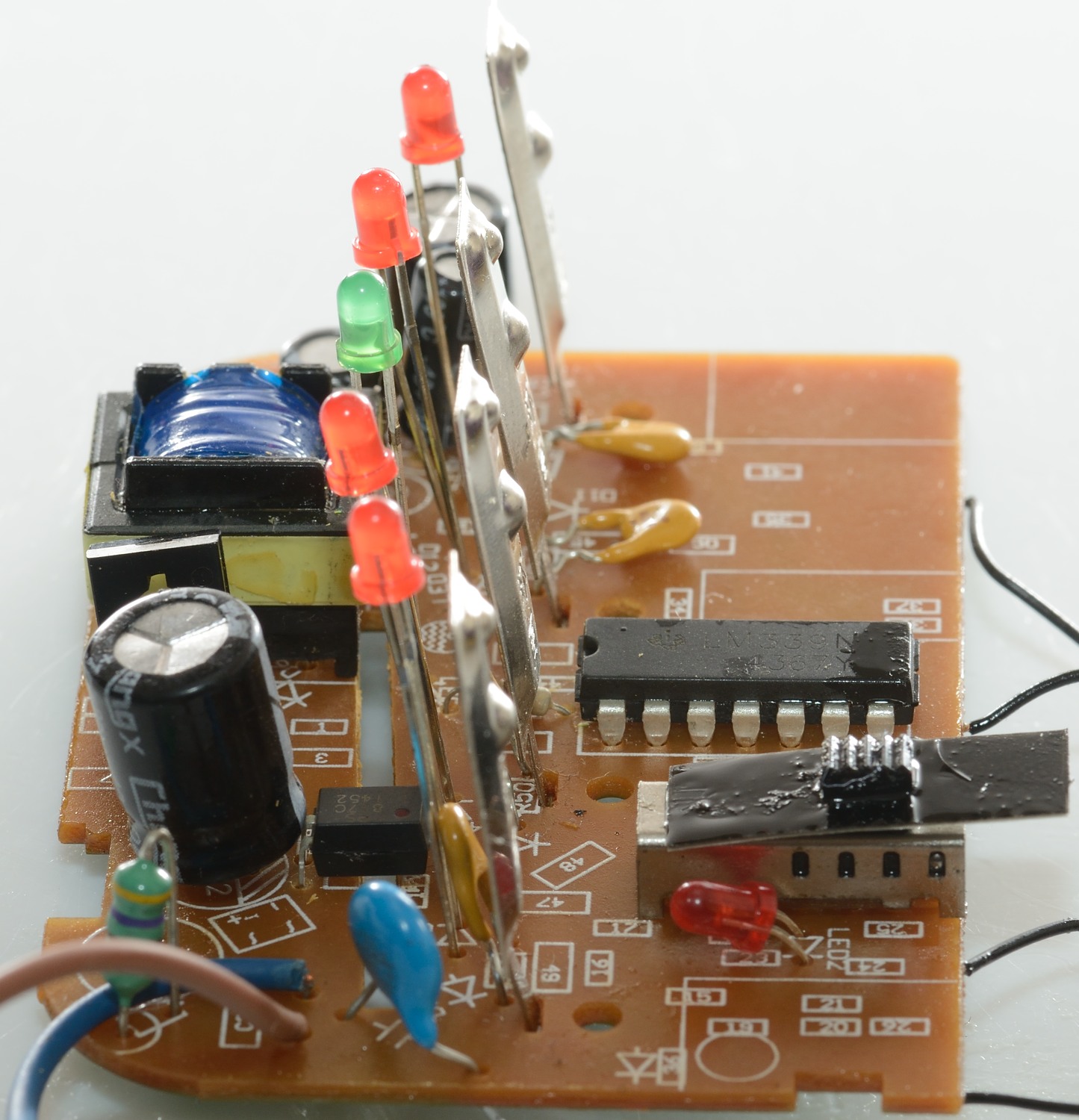

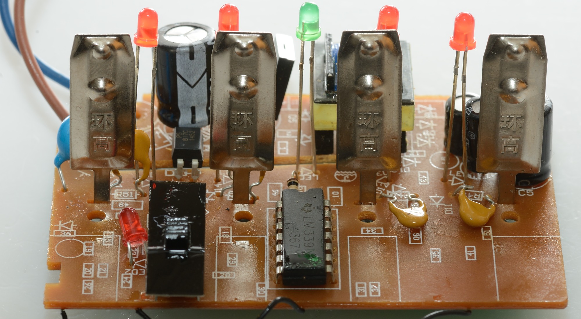

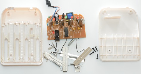

Tear down

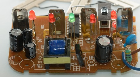

I had to remove four screws to open the charger.

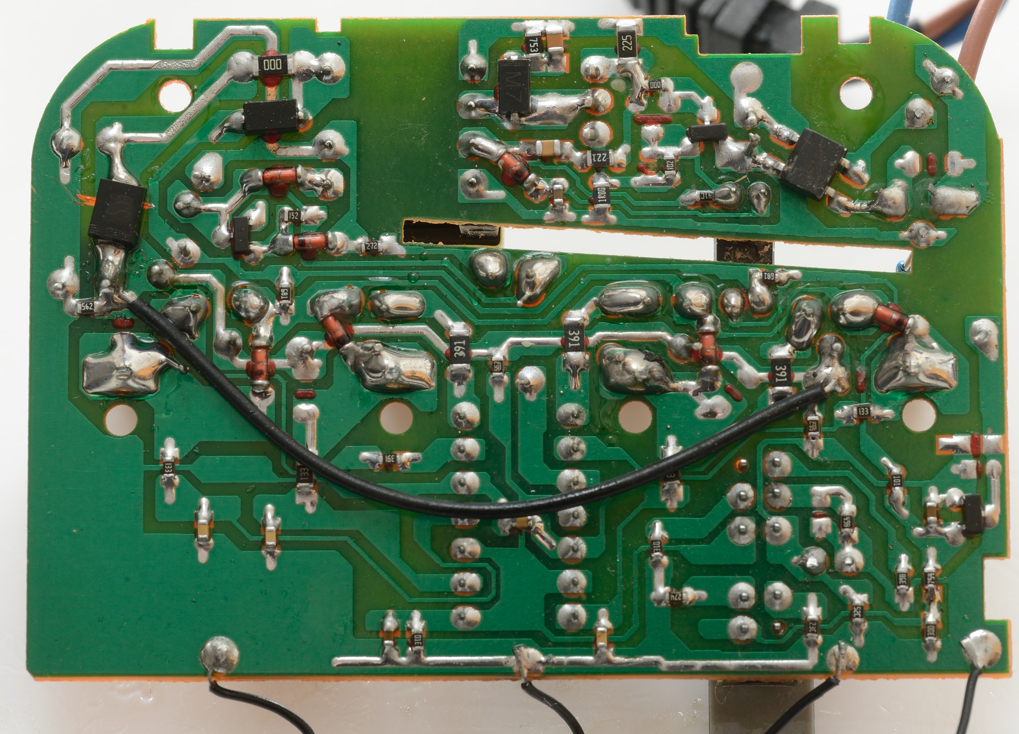

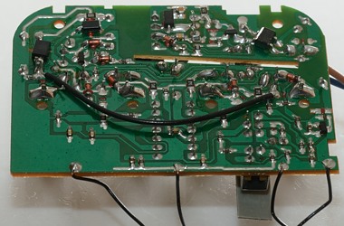

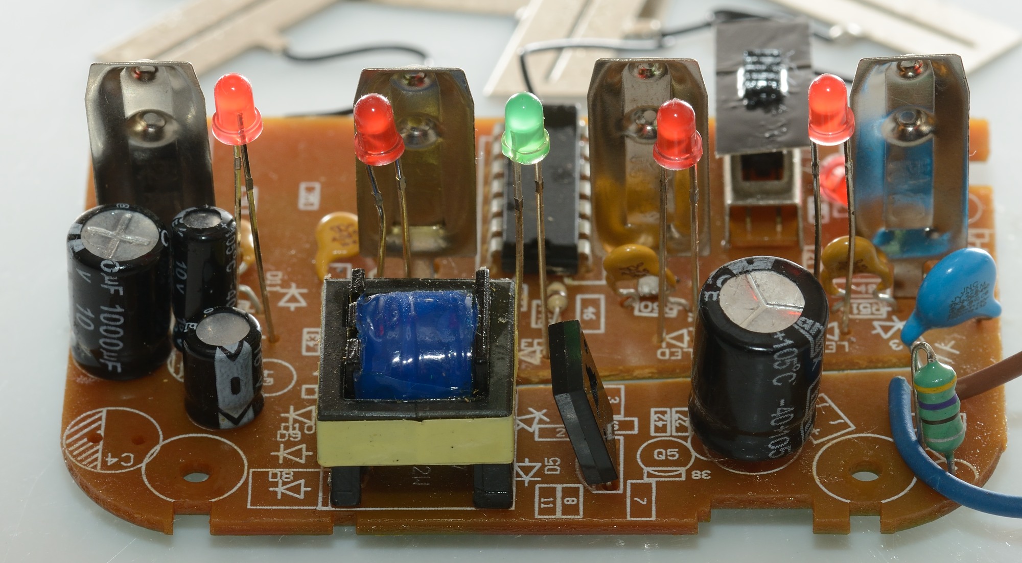

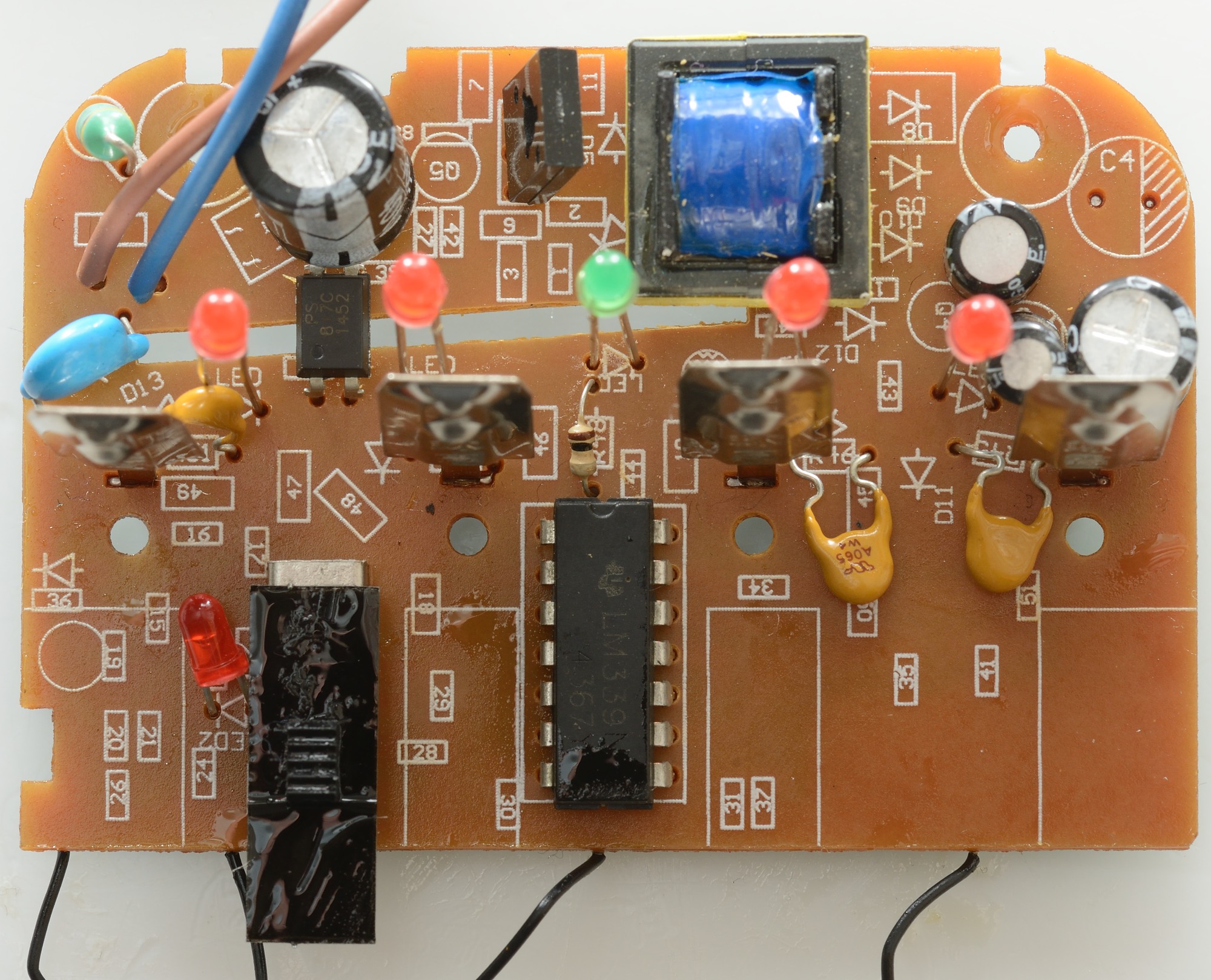

The charger is very simple. On the input side is uses a resistor for a fuse. A opto feedback chip is placed over the gab in the circuit board. The LM339 is a quad comparator and is used to control the leds. I suspect the led besides the switch is used as a reference to control the charge voltages.
The charger has a bridge rectifier on the mains input and uses two transistors to make the switching circuit.
It looks like there is a diode for each battery, to avoid problems with full/empty batteries.

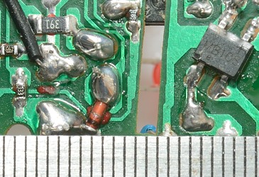

Distance between mains and low volt side must be at least 4 mm (for 230VAC) when some of the distance is through air. This is not the case here.
There is also a problem with the mains lead flapping around inside the charger.
Testing the mains transformer with 2500 volt and 5000 volt between mains and low volt side, did not show any safety problems (But see above).
