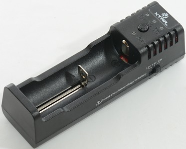

Xtar makes many good chargers, this one is a single channel charger with 3 currents, 3 voltages and able to handle batteries up to 26650 size. This makes it useable for most LiIon batteries on the market, except the smaller ones.
It does also have a usb output, making it possible to charge a phone or other usb equipment from it.

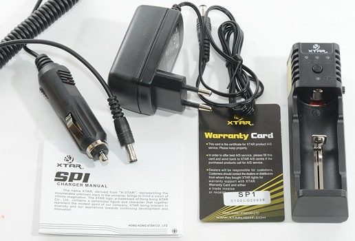

The charger comes in a cardboard box with lots of specifications and batteries sizes listed on it.
In the box is the charger, a power supply, a car adapter, a warranty card and a manual.

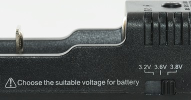

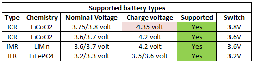

The charger has a switch that can select between 3 voltages, the marked voltages are supposed to be battery nominal voltages. It is very important to select the correct voltage, before starting a charge (See table below).
The actual selection is also shown on the 3 blue leds on top of the charger, before it starts charging and if the switch is moved during charging.

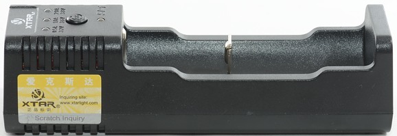

On top of the charger is 4 leds and a button:
3 blue to show selected current and voltage.
1 red/green led.
The button is used to select charge current.
Without a battery in the charger the led for the selected voltage will flash. With a battery in the charger the led for the voltage will flash 3 times, if the voltage is changed.
While charging the led for the selected current will be steadily lit.
The button will step between the 3 current each time it is pressed. Without a battery in the charger the led for the current will be stable lit for a short time, before returning to the flashing voltage display. When charging the next led will just turn on.
It is easy to use, just be aware that the current selection button always is active.
I am not that happy with the markings, they are difficult to read, but when you know the charger they are easy to guess.

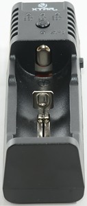

The red/green led is red while charging, green at other times, except when using usb output there it is used to signal charge state.
The charger has a 12 volt input and a usb output.
The label with a hidden code to prevent fake chargers is also present.

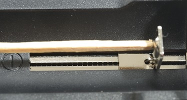

The charger can handle 33 mm to 72 mm long batteries both flat and button top. The slider works fine.
The charger can easily handle 70 mm long batteries including flat top cells.
The charge current is to high for 10440 batteries, except for IMR types.

3.8V setting LiCoO2, i.e. 4.35 volt charging voltage
There is only a few of these batteries on the market. The higher voltage is an advantage in many single cell flashlights.

3.2V setting LiFePO4, i.e. 3.6 volt charging voltage
These batteries has lower capacity and lower voltage than LiCoO2 batteries, but the chemistry is safer and the batteries can often deliver large currents.
This setting is also used for LiIon batteries marked 3 volt (See my article about rechargeable CR123 batteries).
