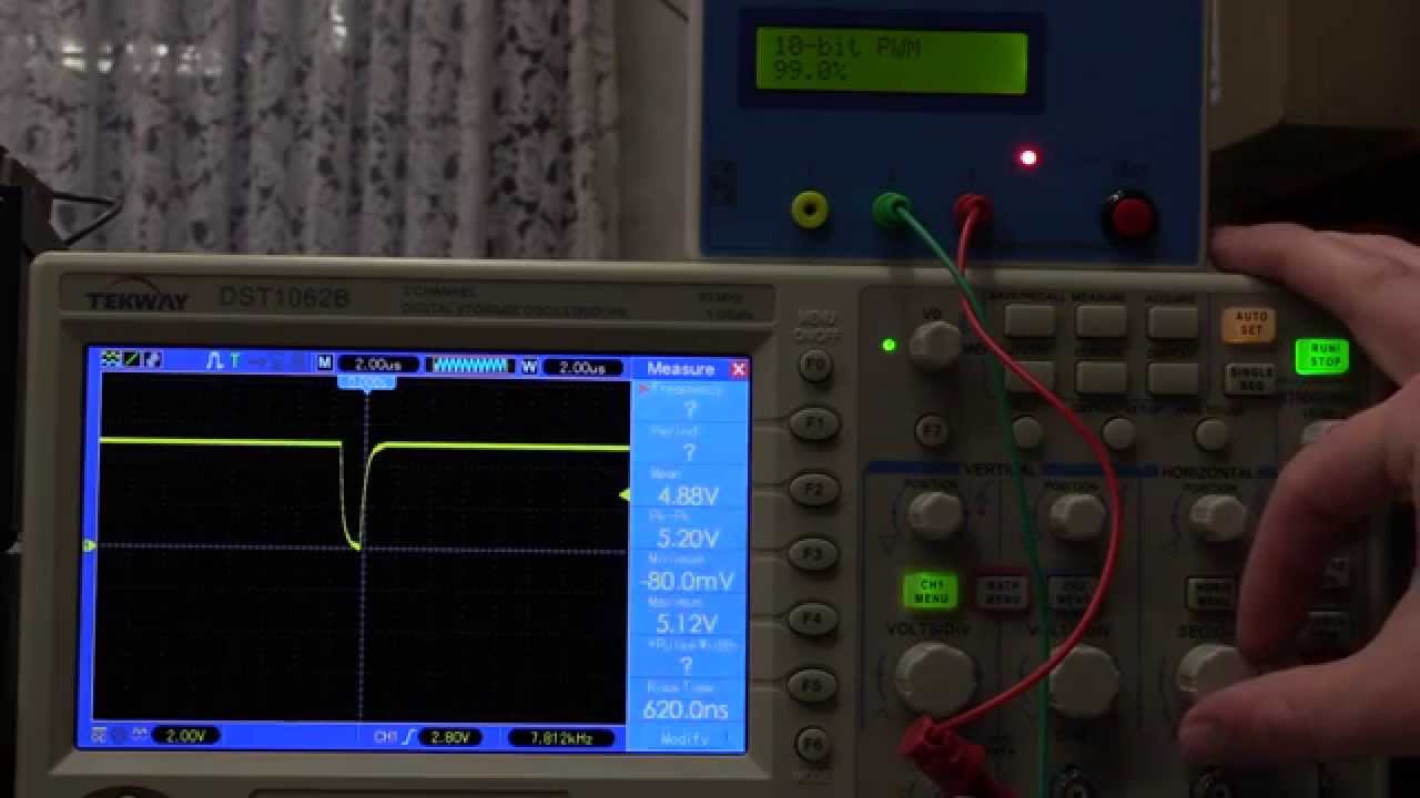

I couldn’t wait, so I just ordered one of these GM328 because it included a frequency generator.
However, I have since found a youtube review showing the model you tested that indicated it also has a frequency counter / generator. Did you happen to check if yours has that functionality as well? I like that it has a case, but prefer one of the other variations with bigger graphical LCDs.
KuoH
I missed that, but it has that functionality.
The units with the fancy extra features require a ’328 processor that has more memory in it. HKJ’s use the smaller ATMEGA 168 processor.
I also bought a couple of the GM328 units. I wish it had the power-off button. It does the auto-poweroff, but it takes a while to kick in. I also wish it drew the diode symbol bigger.
The GM328’s have fixed high parasitic power drain that my earlier units had. They also draw a symbol for SCRs and triacs. My earlier ones just had a text display for those part.
Which extra fancy features, the bigger graphical LCD or something else? It seems from the video I found, that at least some 168 models also include a frequency counter / generator. I do like the 328’s display better, but wish I could’ve found one with a case. I might get this 168 as well, since it can do almost the same thing and has a good case and build quality. As for the power off, I guess it would be simple enough to add a switch in with the battery. It’ll be nice to have something that I can test my cheap scopemeter against.
