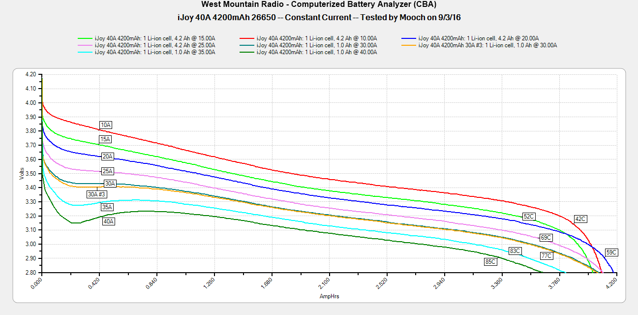

Not sure how to read those charts - they are pulse tests, not continuous? Length of time is not so concerning - we care more about voltage at high drain, say 5A to 20A.
Yes.
You’re right .
I mentioned only as a result of … a little superiority and more of a word that I am a vaper and more I am interested in the pulse discharge (regardless of the Amperes I use).
It looked all dated Jan 20, 2016 if I understand it right, but the list you linked is different, not what I could find. So apparently he did a 26650 summary thing back in Jan 2016, but has tested other cells since.
Even that post you linked to I can't find a "last modified" date for. The June 22, 2015 date on the bottom can't be right.
