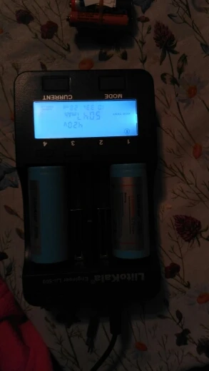

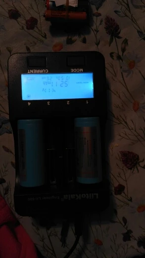

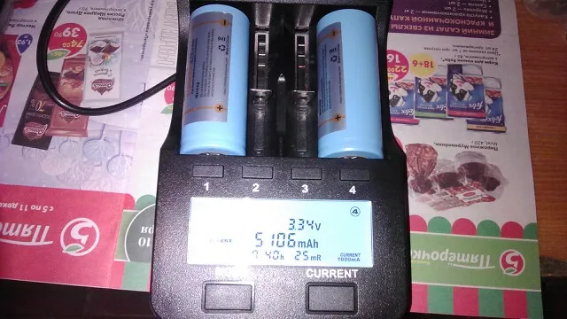

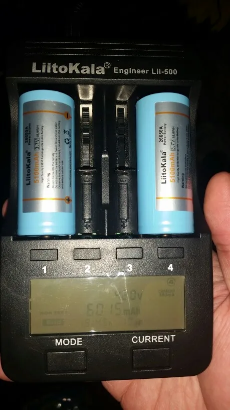

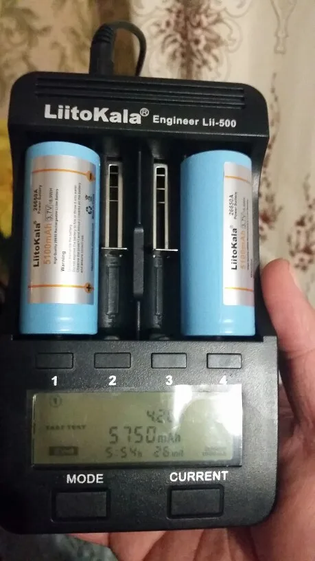

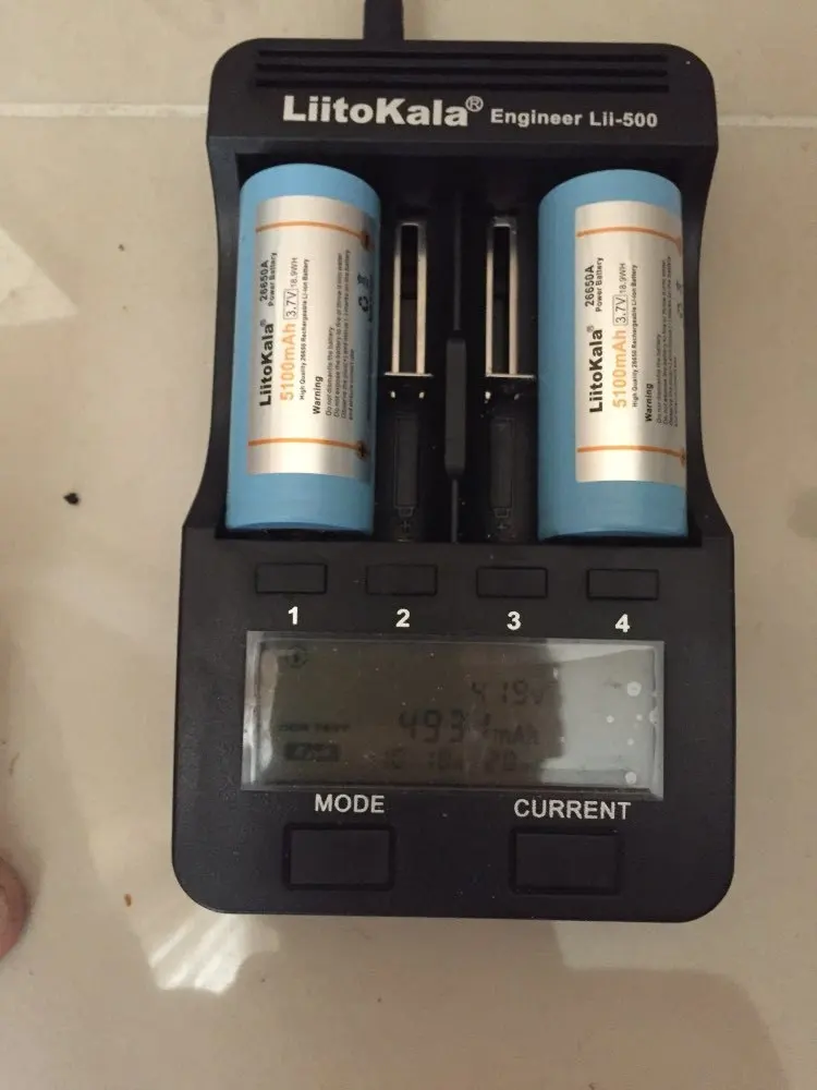

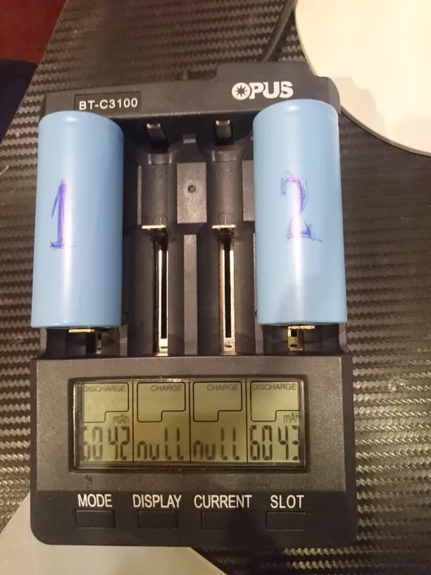

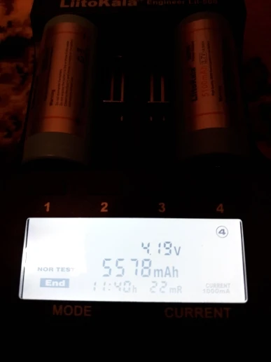

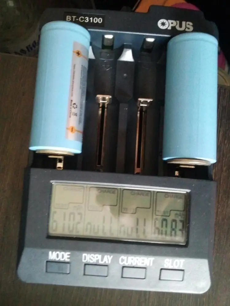

There's, however, wide variance in measured cell capacity even among users of the same charger:
:facepalm: and LoL! :-D with the Opus.
No comments…
There must be something wrong with that machine, I believe.
High numbers again…
Looks normal, though user may improve his information technology equipment usage skills.
Consistent with the above Opus' figures.
Interesting, indeed. Do you believe product quality is consistent but not so with regards to user and charger teams?
Cheers ^:)
Well, were the batteries all discharged to the exact same amount?
Are they the same 2 cells in every test?
Those are cell buyer's submitted pictures. 1st, 2nd, last and each remaining pairs from different users.
Albeit there's quite a discrepancy among the Lii-500 units.
Cheers :-)
P.S.: please don't quote like that. :facepalm:
