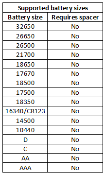

The slots uses the usual construction and works well. They can handle batteries from 28mm to 70.3mm long.
Notice the long bar at the plus end, due to this the charger can handle anything up to D or 32xxx size.
The charger can handle 70 mm long batteries, inclusive flat top cells.
