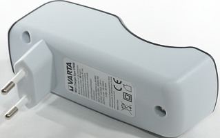

This model charger is with EU plug and only for 220-230VAC. Due to the weight of this charger and the rather high standby power consumption I expect it has an old fashion iron core transformer.

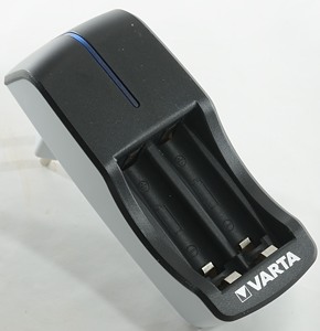

The charger has one blue status led, it will light up when the charger is charging, i.e. when there is two batteries in the charger. The charger will never terminate, you have to keep time and remove the batteries when they are full.

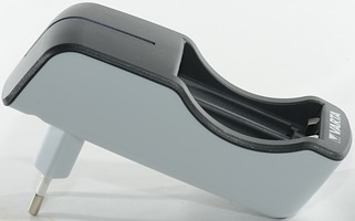

The charger has the typically two level slots used for AA and AAA batteries, only one type must be charged at a time.

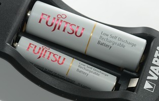

Charger can only charge two cells at a time.
Charger weights 126 gram

A very simple charger, it can be used for cells that is rejected by smart chargers, but it is a bad idea to use it for any working LSD (Low self discharge) cells. The 15 hours specified on the package is only valid for low capacity cells, higher capacity need more time and you have to remember the time. Also remember that it only charges two cells at a time, a single cell will not work.
