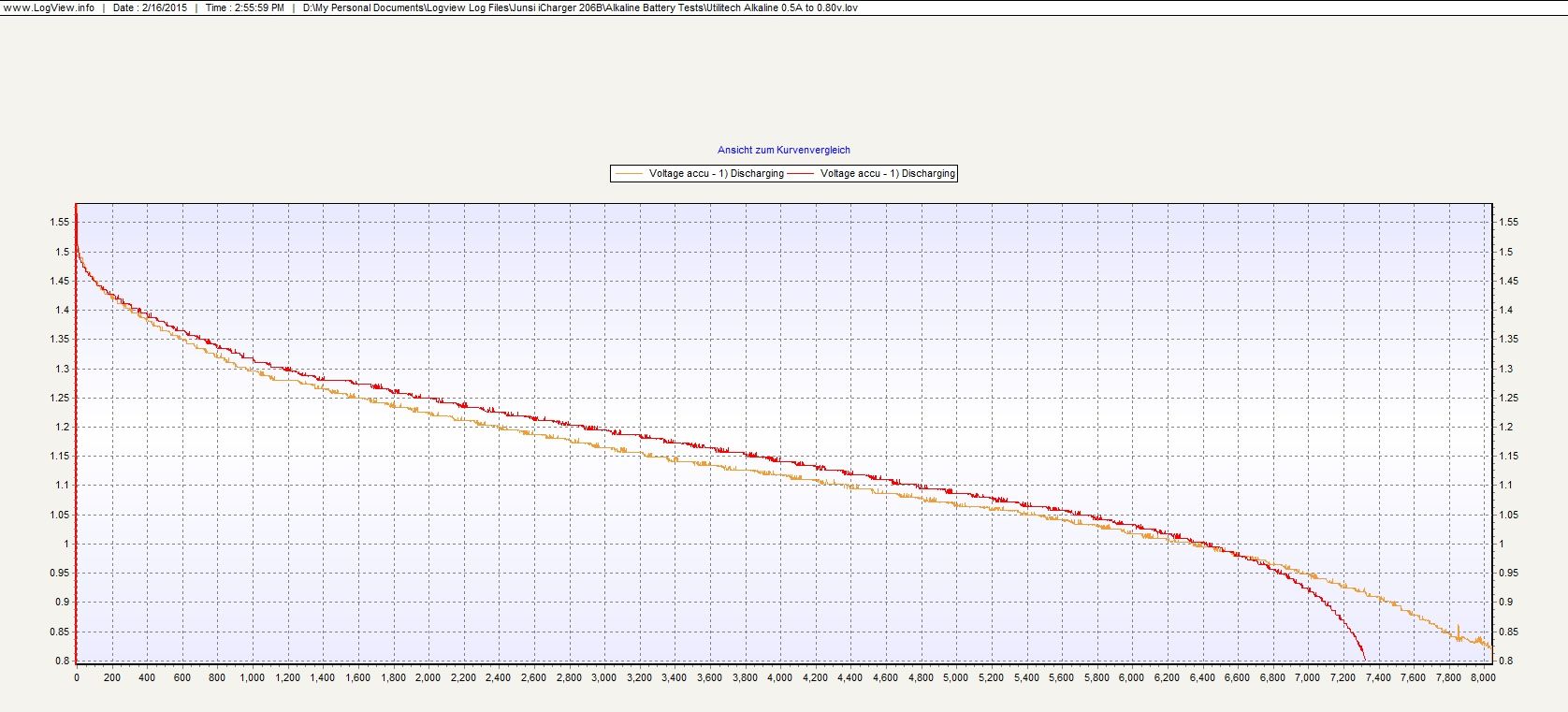

Ok, I just finished testing a fresh new Sunbeam alkaline at the same 0.5A to 0.80v - 1,125mah. Here is a comparison graph between the Sunbeam and the Utilitech. Sunbeam in the yellowish-orange color and the Utilitech in red.
Sorry, I'm new to logview and learning how to work with the graphs.

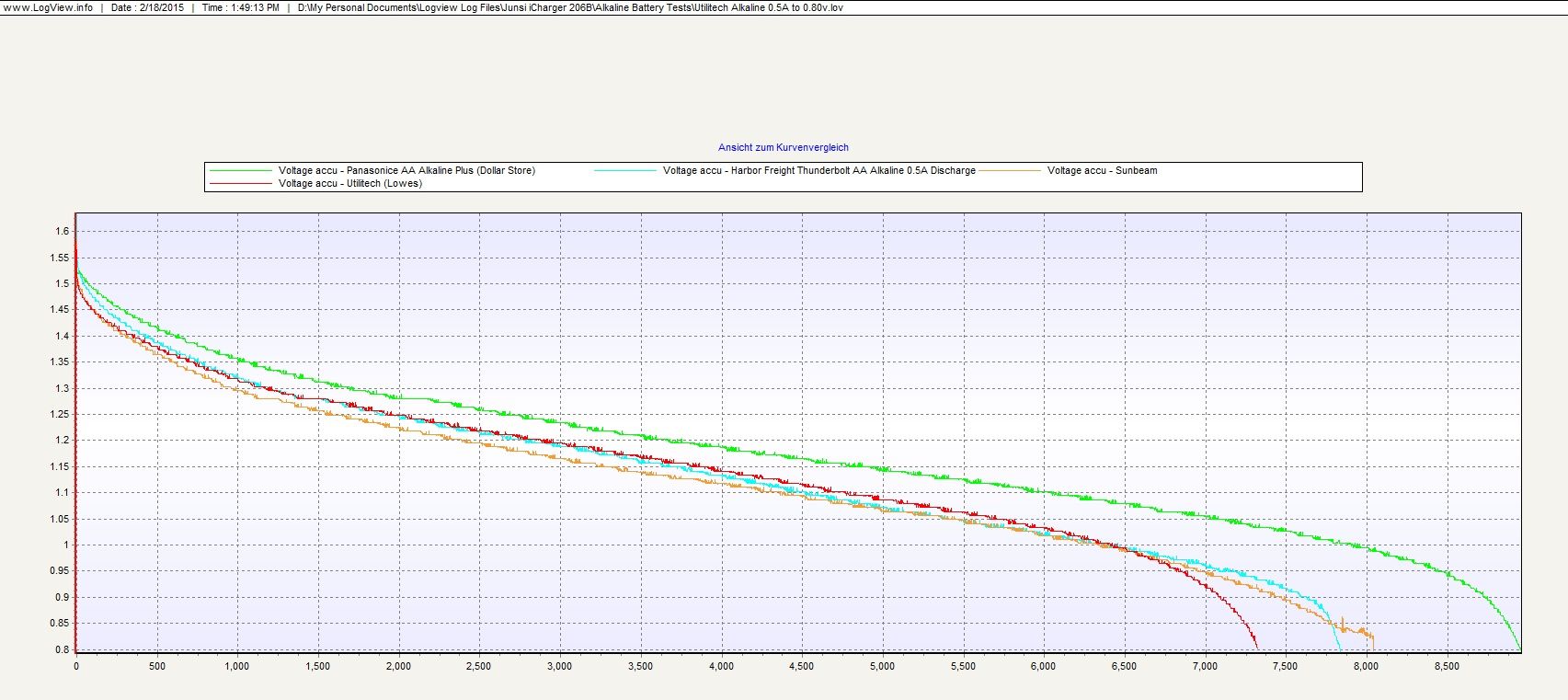

Panasonic Alkaline Plus = 1,253mAh (not surprising to me that it's the best so far). It hold voltage much better too. Graph:

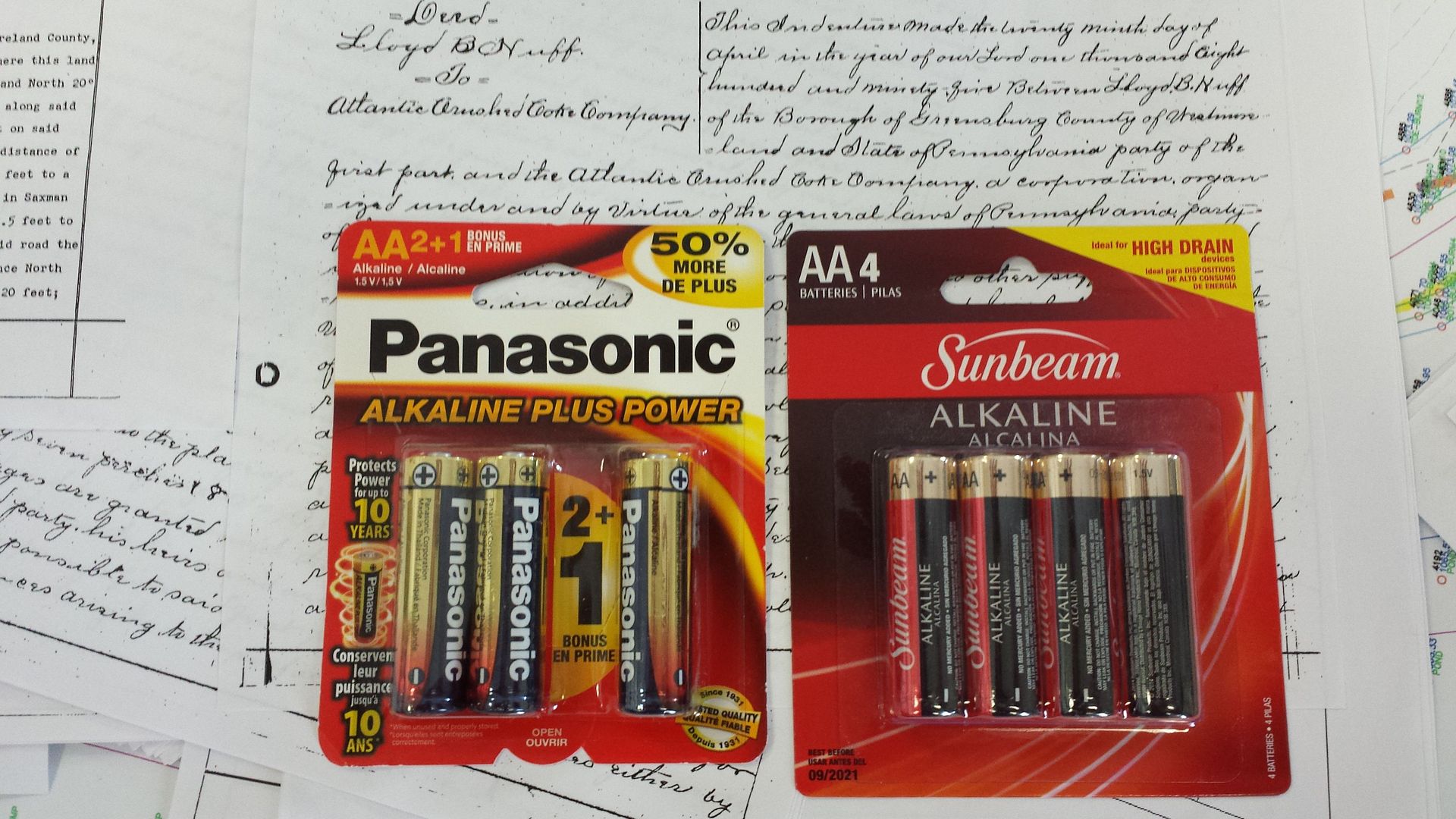

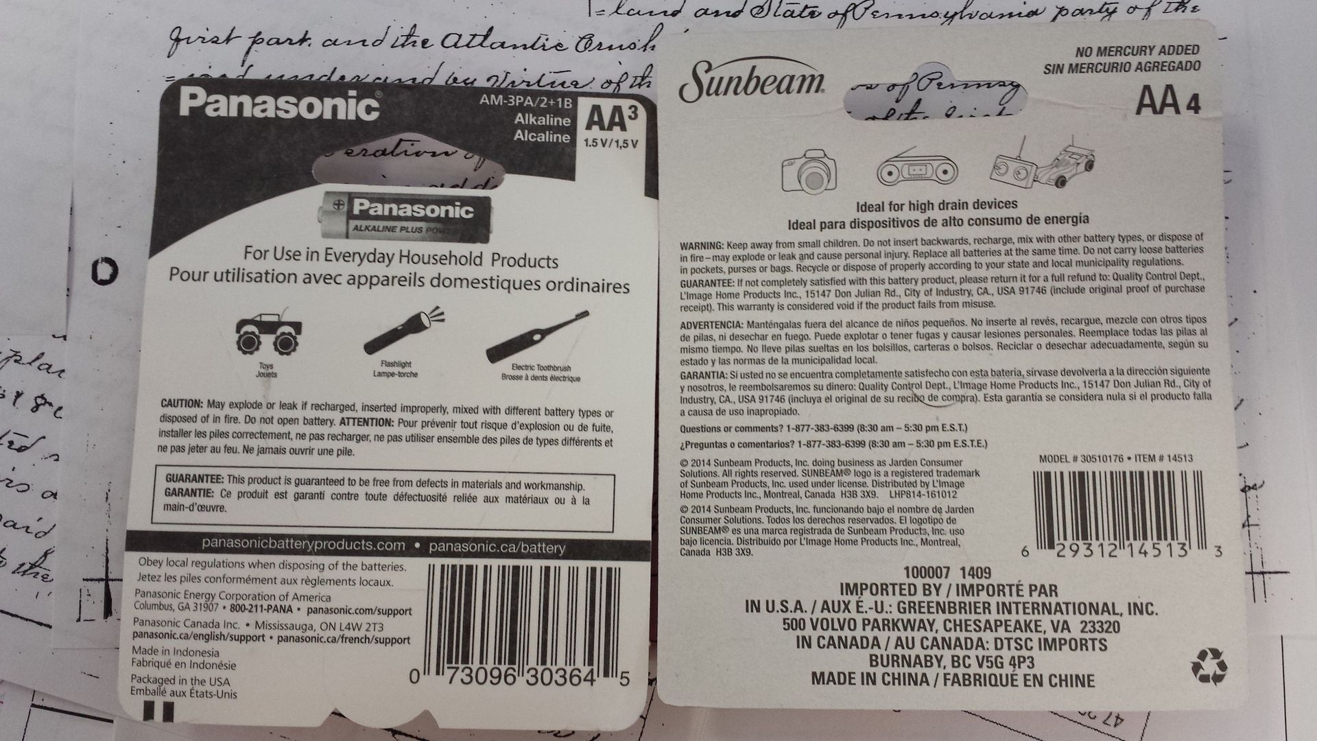

These are the Panasonic batteries (made in Indonesia) and Sunbeams (made in China):
