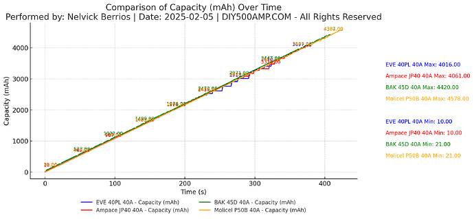

After countless hours of testing, I finally have the first set of results comparing some of the best 21700 high-power lithium-ion cells. This is just a sneak peek at how these batteries perform under a 40A load—full detailed results coming soon!

Could you explain the anomalies of the JP40 plots on the bottom two graphs?

hiccups of my tester at the beginning. The flats are repeated results, note refreshed on time. But data is still good for comparison.

No, it is not good for comparison. That 2nd to last graph has a massive error on it that is beyond interpretation. You couldn’t be bothered to retest it before publishing the results?

Yes now is available. My apologies. This graph was taken from last year. I will update all my graphs with my new equipment soon. I just purchased a West Mountain Radio CBA V Pro - 100V - Computerized Battery Tester.
I agree the graphic is not perfect at all but can give us a very good idea of the performance. For perfect graph lets check Mooch test or Pajda.
OTH, he took the time and devoted the energy and expense to get these tests done. Graphs are not perfect, but I think good enough to be able to see some interesting cell differences. I would thank @ZEUS-FL for doing the testing.
