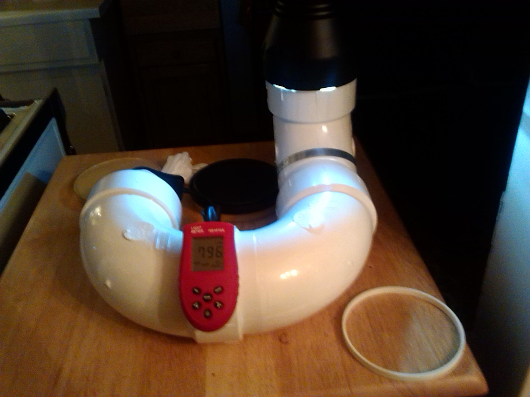

ok so I took the risk and used my 20AWG bypassed carrier with the stock TA FET driver with VTC5A flat tops by removing the anti-reverse protection boards, I measured 8,770 lumen at turn on and 7,770 lumens after 60 seconds, my LED didn’t fry and none of my carrier springs melted, with stock double springs and VTC5A flat tops with removed anti-protection boards I measured 8,500lm.
with 30Q button tops on double springs i only got 7,950lumen
this is with the short tube so im only using x4 cells and not x8
With the short tube and just 4 cells bypasses should be ok. It is when using all 8 cells that it would be a concern. Most likely it would survive but it would be pushing it right up to the breaking point, so only do that if you are ready to replace the LED if it fails.
