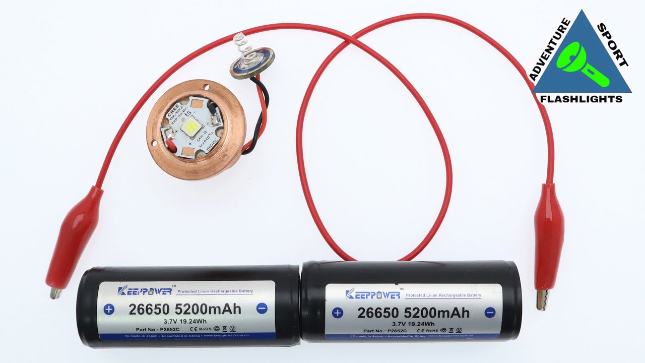

Hi all,
This trick is very simple, but highly effective for troubleshooting and modding flashlights.

In one shot there is a Maglite standing on its head, and you tilt that a bit to see if it the led is functioning.
Of course you have to do that, because you have a wooden workbench that absorbs the lumens.
BTW, that’s why I prefer lights with a (slight) crenulated bezel.
If that’s not the case, I use an opaque polyethylene cutting board. Where I can see the light shine “through”.
You don’t need the full 8”x 10”, just a piece big enough for your largest bezel to rest on.
That also works for tail e-switch lights, too, where the driver’s in the tailswitch.
When the driver works, clicking the switch will change modes through the cycle, but if shorted, you only get one mode, the highest.

The method should also work for side-clicky e-switches, but only for go-or-blow. Ie, keep it connected and then try the switch.
Thanks Matt,
Thank you Matt. I did a variation of this today to help diagnose a driver. I didn’t have magnets or a wire with alligator clips. So, I stripped a decent bit of the insulation off a wire and bent the stripped section up a little bit. Then I set the battery on top of the wire and held the driver on the battery positive with one hand and touched the other end of the wire to ground on the driver. Definitely not as stable as your set up and wouldn’t work well at all if more than one battery was required. It worked ok for me though. Thanks again.
