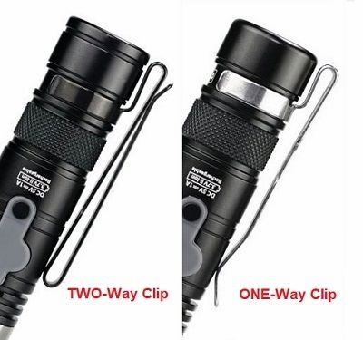

And, thogh not exactly the same topic: which Wurkkos clips would fit the Wurkkos (or Sofirn) 18350 tube groove?
Any clip that fits the 18650 bodies. Same diameter, but generally the 18650 tube clips will be awkwardly long on the shorter 18350 lights.
I noticed that the ‘clamp’ that goes into a groove on the light tube may be of different width? Is that irrelevant?
The 18350 Sofie tube I have has no grooves for clips.
I have no idea where the clip would go on the convoy, I always use screw in clips for all my convoys.
I thought these were grooves and that the clip ‘collar’ width should match them. Workkos has 3 different clips and the widths seem different.
