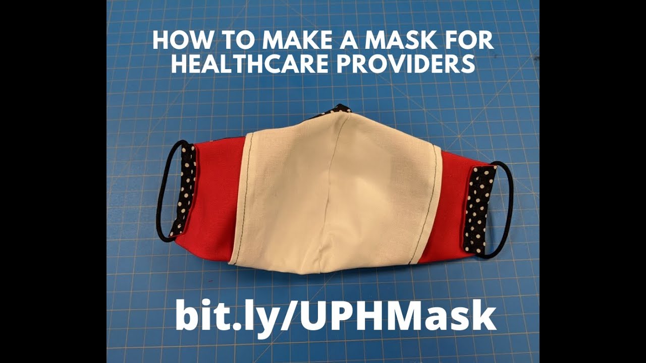

CraftPassion Mask
One of many in this type of design for a cloth mask with a filter pocket. Typical of many – many of the designs out there.
Requires sewing and some skills. Needs to be fitted well to make a good seal. This is critical.
Unity Health Care Mask
The same type of mask from “makers” at a health care place.
Sewing required.

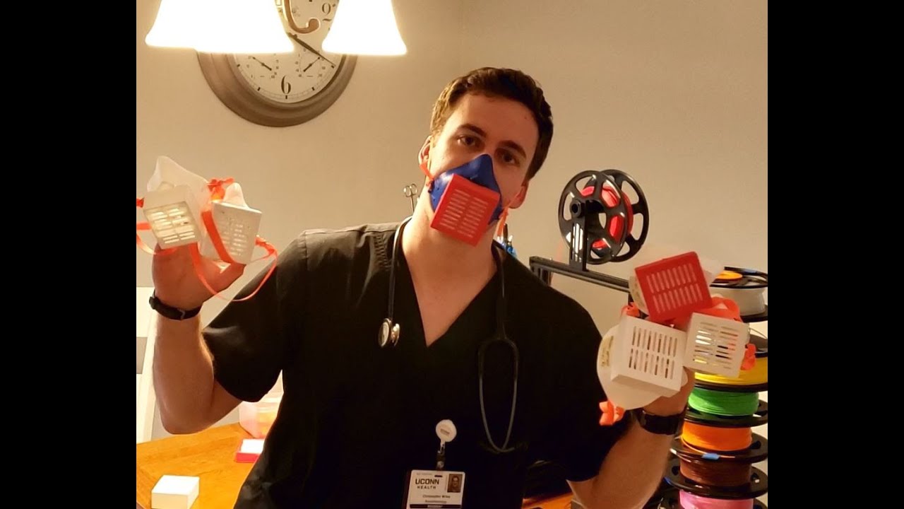

COVID PANDEMIC 3D PRINTED MASK TUTORIAL

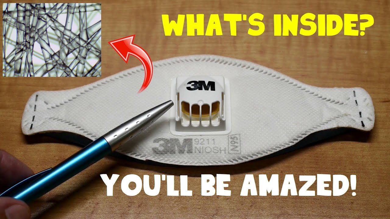

What’s Inside 3M N95 Respirator Masks? Find out!

Dissecting two HEPA vacuum bag types I found them to contain the same looking stuff as an N95.
Non-woven poly cloth. The seams in the bag are fused with heat and it melts at a very low temperature.
The link from bwl123 a few post up shows the same stuff I found in my filter material.
