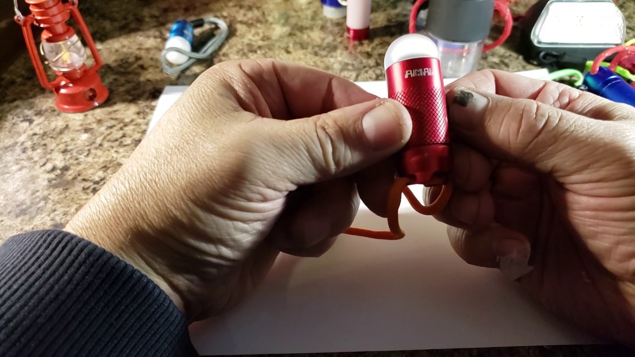

I know a few was waiting for this topic with the video about the many micro lanterns i built & modded, the video shows most of the details.
- These all range from 5 lumens up to 50 lumens, and all brighter than a candle, even the tinyest, wallet size, which has a run time of 20+ hours on a CR2032 coin.
- Also both the micro “Hurricane lantern” and micro camping lantern, (smaller than a C-battery) has run times of 20+ hours on, and have a fire-fly glow mode that will likely run for 4+ years on a CR2032.
