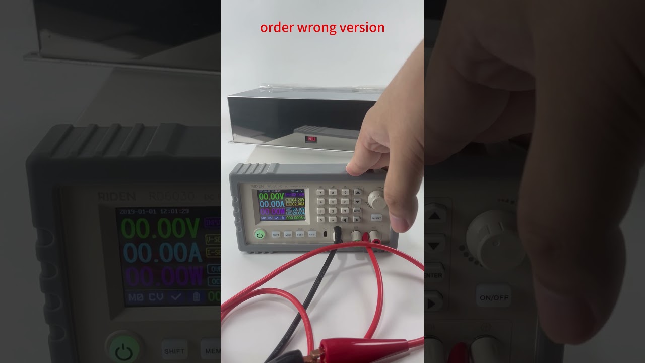

hello, if you order the wrong AC voltage RD set, what you can do? you can open the case, find AC to DC part, it is a switching power supply, on the side there is a red switch, switch to 110V or 220V you need, for AC power cable, find a computer AC power cable and it is ok
