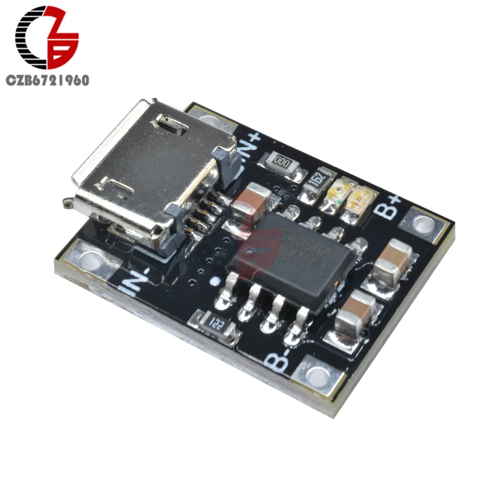

Newer, more compact size version:
https://www.aliexpress.com/item/32967650561.html
https://www.aliexpress.com/item/32966356149.html
No type-Crap yet LoL.
