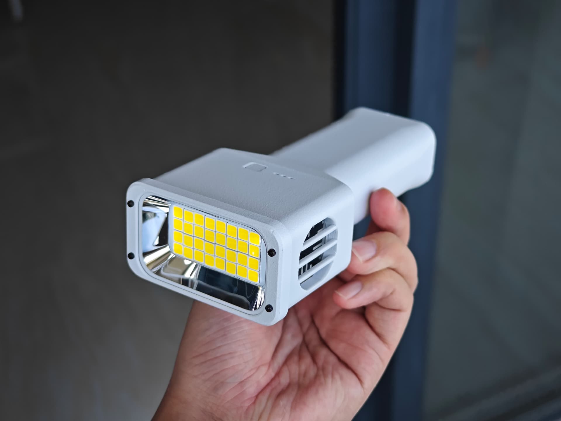

The ONLY Flashlight That Holds 4000 Lumens! Cyansky Hammer
The idea for this flashlight originated from an open-source project by a Chinese flashlight enthusiast, a project series called “Light Hammer.” The author permitted its use for all legal and ethical profit-making purposes, such as printing, assembling, and reselling by yourself.
Cyansky’s version has clearly made many changes, but in terms of appearance and name, they have obviously referenced the original project. They at least owe the original author and the open-source project a thank you in the product description.

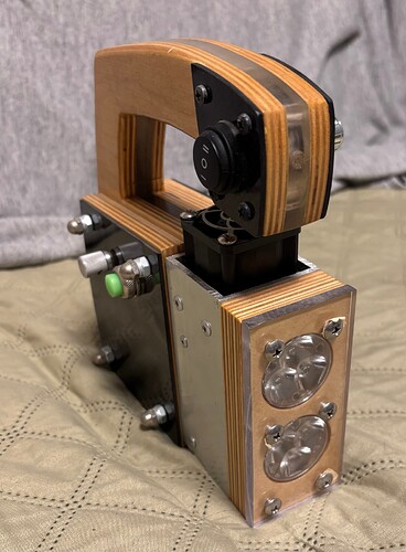

This light I build from scratch more than a decade ago, can hold more, 12xpg2 running at 1.5A and it has TIR optic, and some decent throw, active cooling, side uv triple running at 1A, and amber back lights with 5 modes.

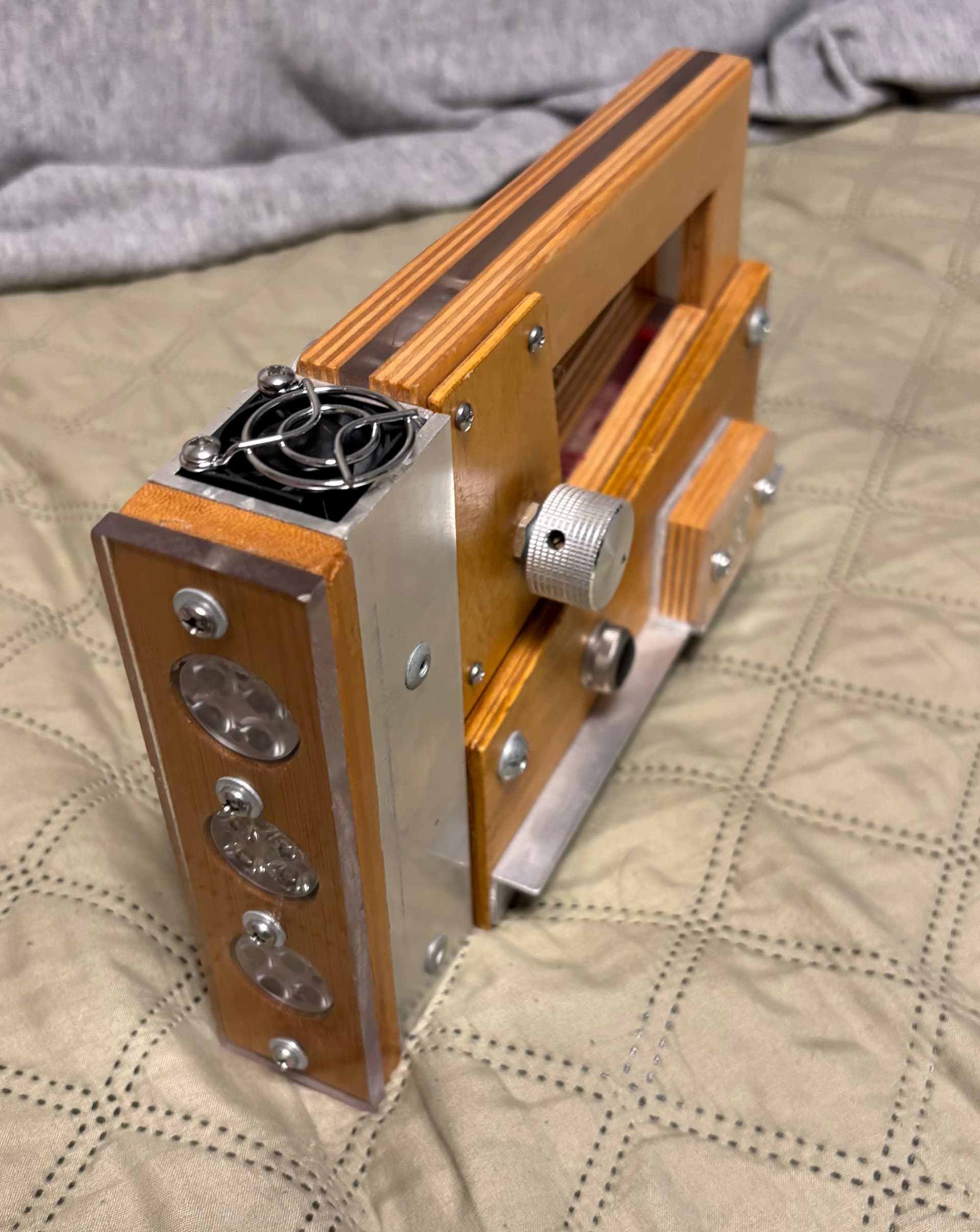

Or this one, 6 xhp50, can hold around 10k lm as long as batteries last, active cooling, 3 separate rear facing leds, red amber and UV.
Both can be used as hammers, or be used as a strike device, with no adverse effects, unlike a 3D printed Lights that I would be afraid to drop, I have designed and build 3D printed lights and other items, One of them I build for a scratch build contests here on BLF, many years ago. I have not build anything for many years, due to getting 2 kids, maybe when they grow up a bit I’ll have time to continue, hopefully.

That’s a sick build, @alpg88 . Time to update with dedomed 519’s, maybe?
You’d think so :rofl::rofl::rofl:
The imalent ms32’s as well..
Thanks. When i’m able to do it again, I’ll build new lights with 519, or something else, I rarely update these, I just build new ones, that is how I ended up with about 2 dozens, most of those are given away to friends. While I’m unable to build for now, i’m very much able to come up with ideas and make sketches. I also buy parts and materials if I come across something interesting, I have some crazy ideas, but they will have to wait.

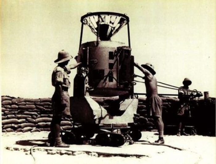

Or a more realistic approach
The issue is that with each additional facet or reflective surface, the luminance is divided by that many more. So if it’s a triangular wedge, then 1000/2 and reduced lux, but double the frequency at the same rpm. If a pyramid-like shape, then 1000/4 at 4× frequency at the same rpm. If it’s just one concaveish elliptical/scoop mirror, then that focused beam could retain the full brightness, at whatever rpm bas frequency.
