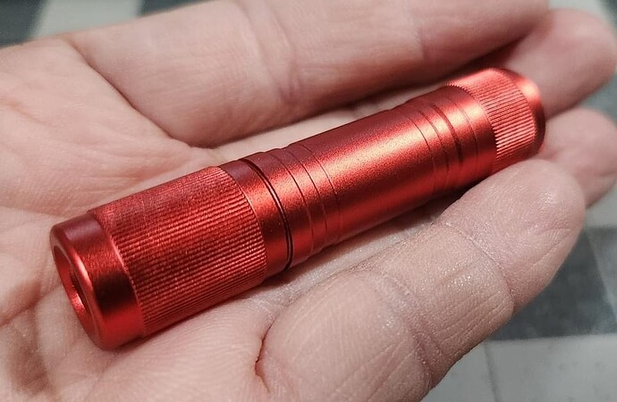

Jackson Lee posted it on FB
7 Thanks
Looks like a twisty, but it is a very pretty design at least, hopefully Hank redesigns the tailcap so it can still tailstand.
I have to wonder though, what the UI will be like.
First Hank light without Anduril :eyes: The end of times is upon us lol
Oof. Guess I’ll only be buying one then, heh :stuck_out_tongue: .
Really though, would love an anduril keychain light…
It’s definitely not the first (original D series, M43, etc), but it’s the first in quite a few years.
I trust Hank to make a good light, if anything it reminds me of the Maglite Solitaire. I’ll probably get two or 3 depending on price (519a 5700k dd, w1, 519a 3500k d)
What the Frog couldve been if lumintop didn’t suck
It’s a keychain light, they are better attached to keychains rather than standing on a shelf.
The DQG Tiny AAA IV had an interesting tail design which could tail-stand and be on a keychain at the same time. I’ve never seen another light use that design though. Basically, the tail end of the light has a raised “O” shape around the edge. A small ring goes through a hole in the wall, and it can flop to either side where it fits into a notch. That allows it to lay flat for tail-standing without removing it from a keyring.
Pictures are in this review.

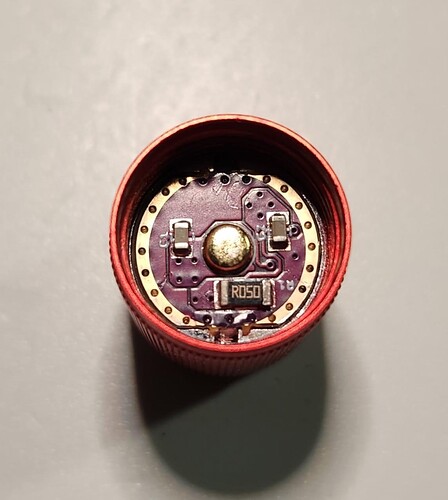

OTOH, if the info I saw is correct and this is a 2A 1-mode driver, it wouldn’t be suitable for tail-standing even if it had a stable base, because it would get too hot. That would be like 700 lumens for 9 minutes… and for tail-standing (or a keychain light in general), I’d much rather have 7 lumens for 900 minutes.

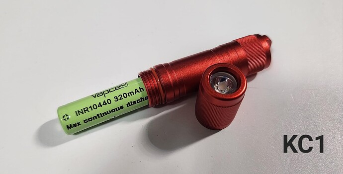

1 mode, AAA, 10440,14500 flattop. 17ish dollars.
Not so sure about 14500 tbh, but I think that was a typo.
