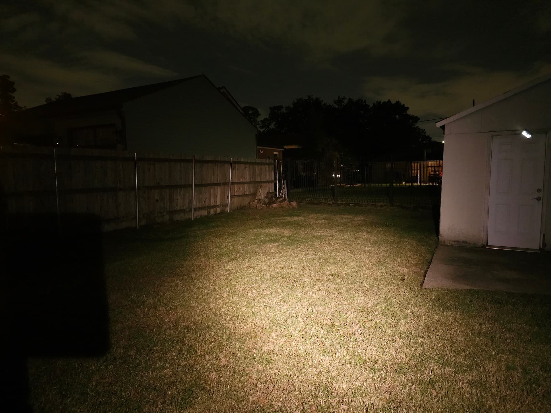

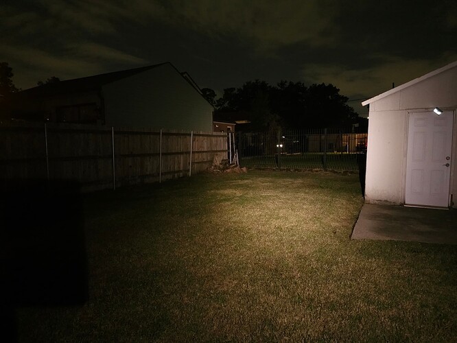

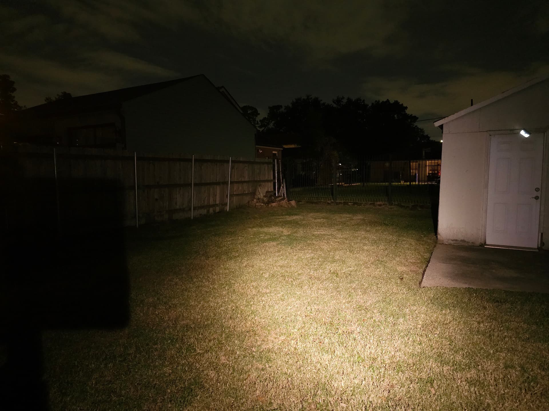

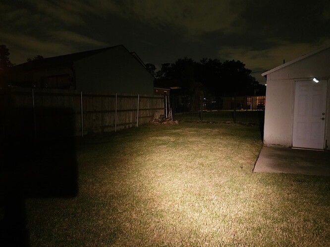

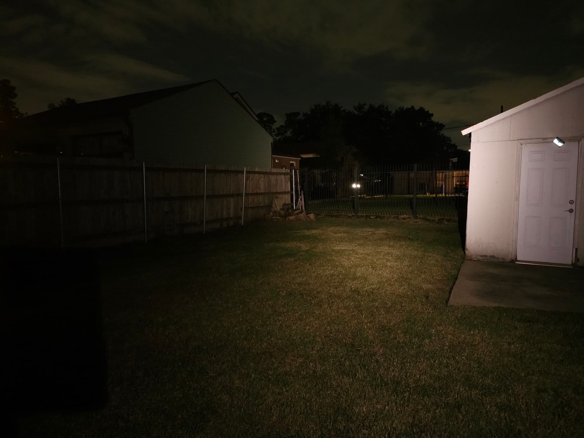

Beamshots:
vs Skilhunt E3A (left):
More beamshots with comparisons: Emisar KC1 outdoor beamshots (with comparison beamshots) : flashlight
