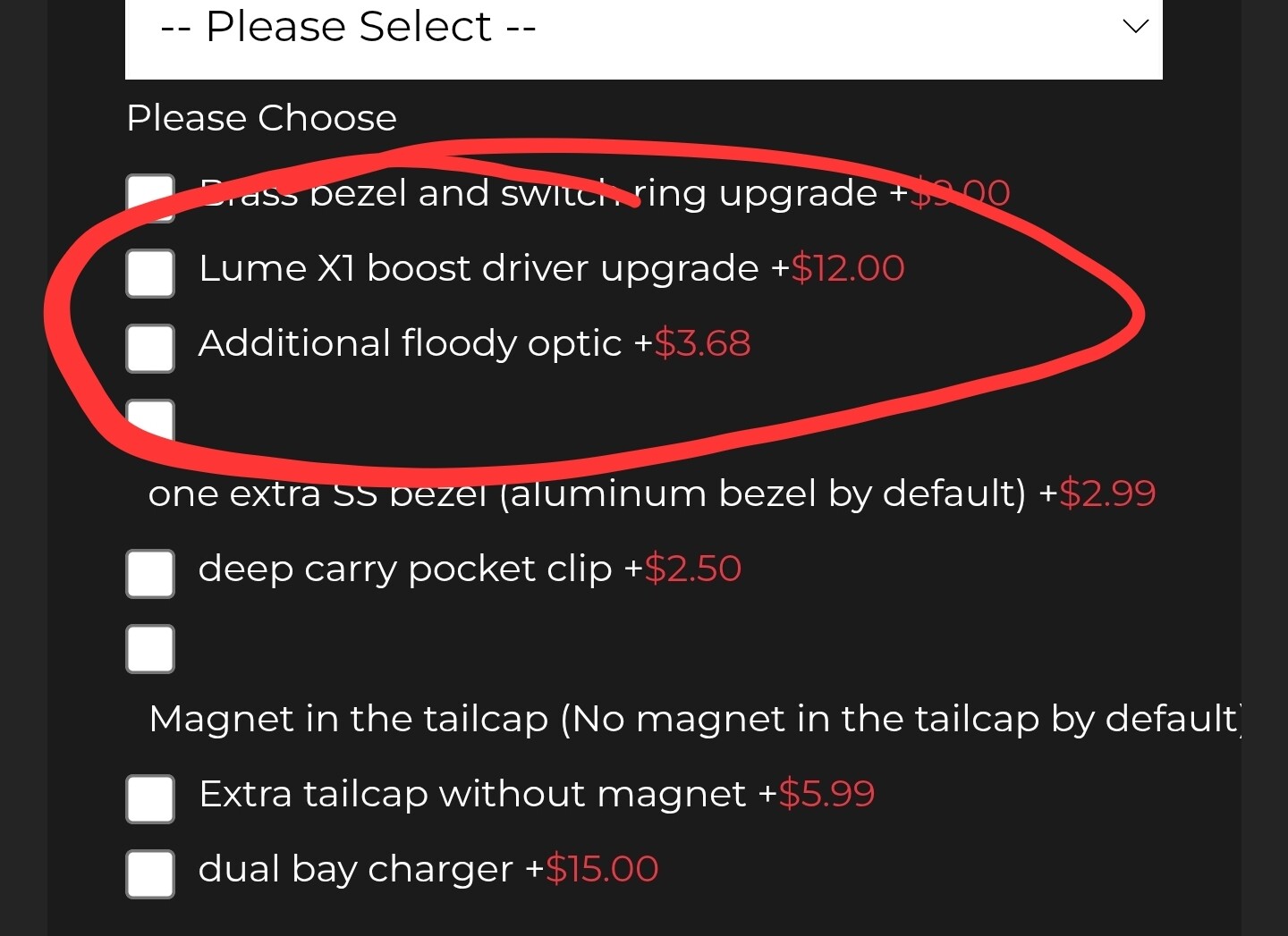

From a post on Reddit it seems the Lume X1 driver is available in the D4V2 now.
@Hank_Wang can you confirm if this is the standard boost drive option or a special request?
Is it available in other 18650 lights?

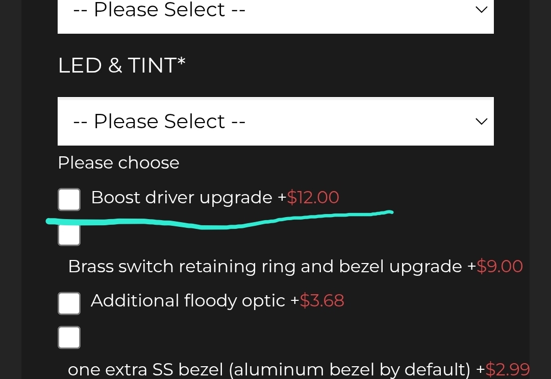

UPD: that’s the old boost driver
Sure thats the boost driver upgrade option that has been there for years. Doesn’t say anything about it being LumeX1, which is why I am asking.
Screenshot of D4K page:
Sorry, I thought it’s the same upgrade.
Wasn’t the issue with the X1 driver in the 18650 lights was that it was physically unable to fit?

Hi, D4V2/KR1/KR4 version Lume X1 drivers are not available for now due to the components shortage, so, the “boost driver upgrade” on the site is still the old version boost driver.
